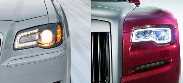

Looking for ideas. I love how some of the newer cars have lights that frame the inside of the headlights. I think this would be a great look in the stock 4Runner housings, but a full square maybe... You don't see indivdual leds, it's more CFL lookings.
Ideas on how to do this?
Similiar to this, but a full square.
Thanks. I called them, but since these are strips they said it won't work. He liked my idea, but said they don't have anything to do this.... Hmm

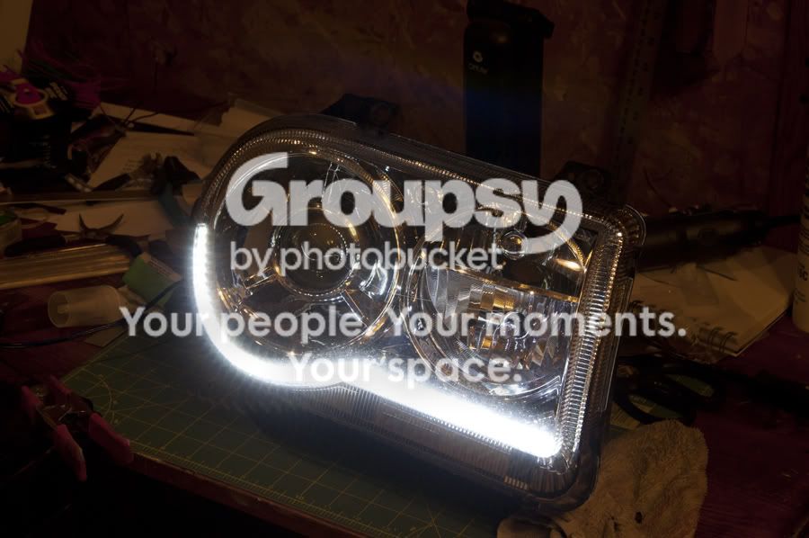

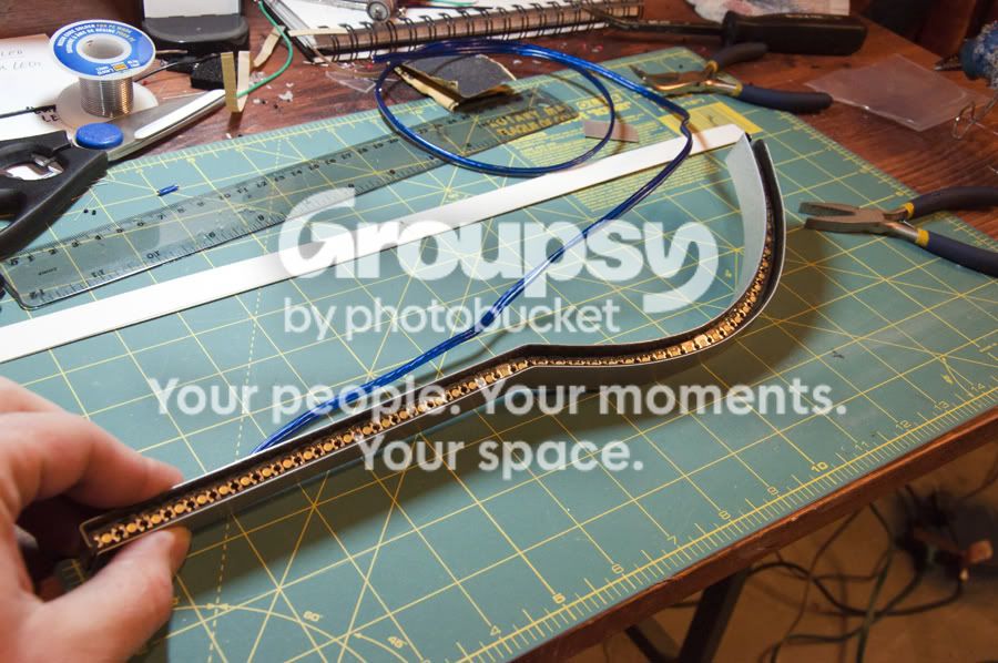

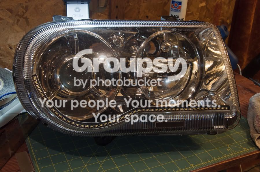

I remember seeing a fellow on my old forums who used some window blind rods, clear of course, and used an oven to heat and to shape them, drilled a hole in each end and inserted an LED diode in each end and it looked really good. Much like this:
That is really similar to the way audi,bmw and others are doing it, they use some optics (made of clear acrylic) and then they use a single high power diode at one end.
