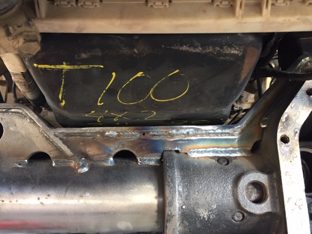

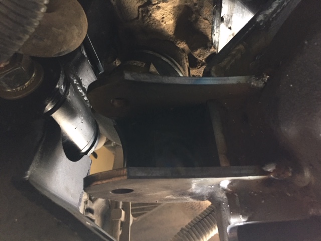

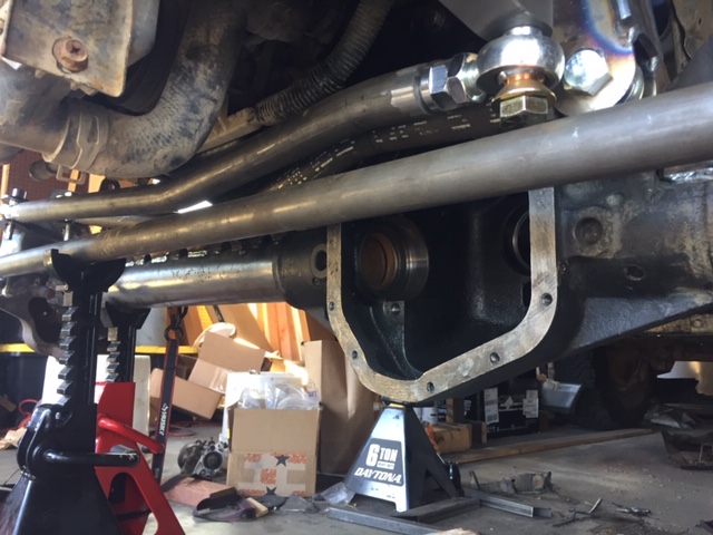

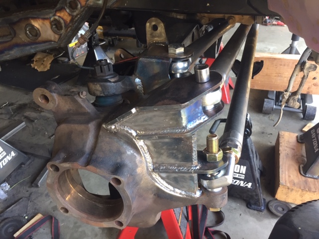

Axles (both front and rear) are from a 2004 SuperDuty. I went with these axles for a few reasons, I wanted tons but didn't want to go as wide as the 05+ SD axles (the 99-04 SD axles are narrower), the rears have a super cheap OEM e-locker, and they have a ton of aftermarket support.
Yes, it will be California smog legal and streetable. I'm getting close to finishing the front (well, finishing it close enough to roll it out of the garage). Some pictures of it at full bump (yes, clearances are very tight):

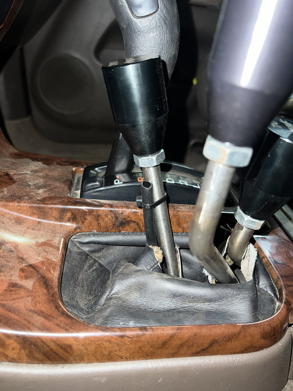

I believe I have the first Marlin Crawler Lefty put behind a Toyota V8. It was upgraded with Marlin's "Competition" gear set that may be the reason it's lasted all this time without breaking. It also has the 30 spline output shafts that were a pretty new upgrade when I got mine (2009).
The case is strong but I would disagree that Lefty's are stronger than the newer chain cases. I think an FJ Cruiser case with a taco box is probably a stronger setup.
The main reason I went with the Lefty was the size. It went right into my 4runner without needing to modify the fuel tank. The only modification to the floor board was making the hole for the twin-stick to come up through. It even allowed me to keep the 4wd light working in the dash.
The lower range is a significant advantage over stock but you can hear some gear-whine being a geared case.
I've had it behind the V8 and pushing Dana 60's with 40inch tires and it's held up all this time. I think it's also how I drive, I try to crawl and always try to limit wheel spin with the skinny pedal.
I'm moving to a Behemoth D300 4 speed but it's nearly 4 times as expensive. This will also be new territory since I haven't found anyone else who's tried to put one behind a Toyota A750f trans yet.
It would be cool to see Marlin Crawler or Inchworm produce the Lefty again because I think it's a good case depending on what you're building. If you want strength though, I still think a twin-stick FJ case with a taco box is stronger if you can make it fit.
