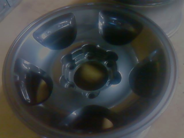

I just bought a set of 94 LC wheels. I finished painting them on Sat. They are a charcoal metallic and match the flares of my runner. I can get better pics I only had my phone where I was painting.

The back spacing on the LC rims are 4.5". It pushes the wheel out an inch so it lines up perfectly the limited flares. No more sucked in look. I know they clear the UCA's with 285's with no spacer. Not sure on bigger sizes.
These 5 stars use to fit with my old 285's. Theres no way the 315's would fit. The lc rims im assuming would be the same way. I didnt think it would be so hard to find rims.
