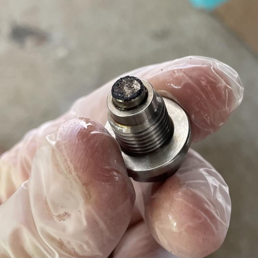

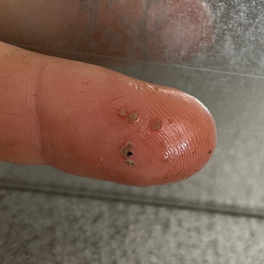

I also drained a quart of oil so I could check the new magnetic drain plug and take a look at the oil. Well there is a very small amount of metal particle on the drain plug but since it's never had a magnetic plug it doesn't seem like a lot by any means. Just a light ring around the magnet and a bit of fine silver coloring that you can only see when you wipe it off on a rag. My guess is that's pretty normal. That with the outstanding results from Blackstone labs is making me think the engine is OK. I did find some funny little particles of what appears to be grey plastic in the oil. Maybe some old silicone gasket material that's dried out from engine heat. Or a worn component. I don't know but it was small and non magnetic non metal and quite brittle.

Here's the drain plug and some of the plasticky bits I found in the oil. Yes I cleaned the catch pan really well so I know it wasn't there already. Although when draining the oil I pulled the magnet (new plug) and popped in the old plug so I could inspect the new plug. In doing that I definitely brushed against the frame/diff and some rusty paint flakes made it into the oil bucket, but I couldn't find anything under there that resembled the grey plasticky flakes so I'm stumped on that one and concluded that it must be from in the engine. To be honest I have never inspected my oil this closely but I've never had a truck this nice and usually just changed the oil and kept driving it ignoring any minor noises because they were old beaters hahaha.
