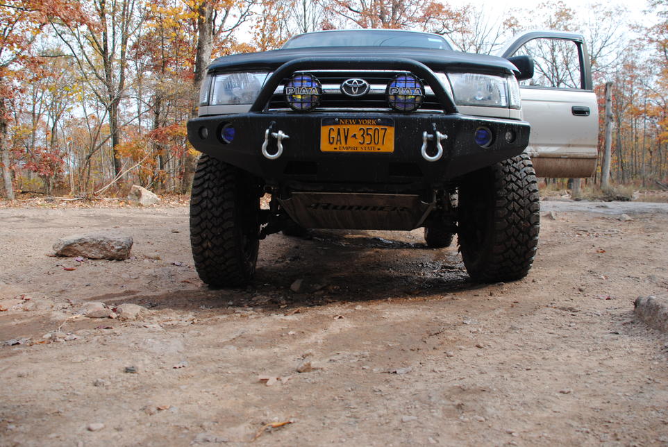

I'll start with my front skid. Made from 3/16" steel plate and tied into my radiator cage. Things I need to change are more bracing and recessed bolt heads to keep from damage.
Both bumper and skids were done by RLCWeldFab here in Louisville, KY. Being a custom built bumper, I need him to make me some skids too. Came out great. I need to do recessed bolts myself.
I like the simplicity of those skids. If they get destroyed, they are easy to duplicate. I plan on abusing mine so that is something that I like, rather than making them super beefy and heavy.
Question though. What's the reason for the large opening in the front of your bumper? Seems like a vulnerable spot for damage. Maybe add some thick mesh or thin plate?
Oil Drainage?
Not planning on it. I don't change my own oil. When I get an oil change I just pop off the skid, drive down to the shop for an oil change, get free car wash, clean everything underneath the engine, then pop the skid plate back on. Plus rocks and dirt don't get underneath the engine and skid as much.
