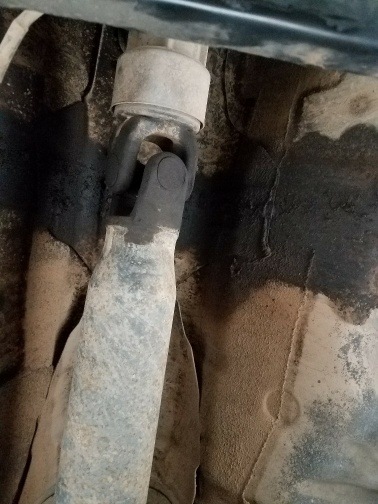

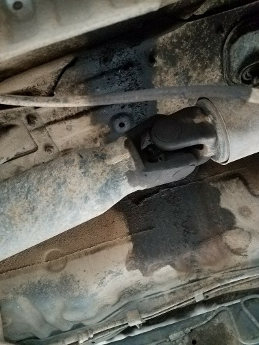

Short story: My front u-joint gave out on me...and now im weighing out my options.
Long story: started getting a slight driveline vibration when releasing gas pedal at 60+ mph. This was months ago. This past month a rehearsed to 4.88. Shortly after the slight vibration turned to heavy vibration when driving at 70+. My thoughts were lift changed the angles and what not that the u joints had been sitting for decades. New gears added more stress to joints with the ability to turn wheels with more power. Sure carrier bearings improperly installed crossed my mind but and I was hopefully that the u joints might just need a regressing to relubricate but then I got under the truck and found this...
That's right front u joint seals are toast. I did pack with new grease knowing it would spray more but hopefully slow the progression until you folks chime in on my options as I see them.
Options:
1: replace front u joint only . OEM part cost $100
2: replace front and rear u joints...back one is likely to go out shortly although no play is noted. OEM part x2 cost $200
3: after market driveshaft replacement. Has both front and rear u joints replaced, also takes care of potential 2 piece coupler rubber seal that is also 20+ years old on current shaft. Labor to swap is easier, quality of parts may be unquestionable. Cost $330 - $400.
4: OEM drive shaft replacement. Same reasons as option 3 but takes away questionable parts. Cost $500. ( I know! Knot as pricey as you thought right!? Considering u joints from dealer are $100 each).
Now before you folks tell me $300 on Tom Woods and I'm good to go. His site specifically states he doesn't do 2wd drive shafts, which is what I need. And like an ass hole I still emailed to verify that he won't make it.
4wd conversion is in the works so the driveshaft will be obsolete at some point ( [MENTION=139000]phattyduck[/MENTION] situation haha, he knows what I'm talking about). I just don't have a timeline on when the conversion and part collecting will be complete.
So with that said. If you were in my boat, how would you proceed? No right or wrong answers just want to hear from the community to help weigh the options.

Are you sure the u-joint grease seals are toast? The splay of grease under the rig is normal to see from greasing the u-joints. The extra grease that squeezes out of the bearing cups gets flung out do to centrifugal force. Does the joint have detectable play?

Tim, OEM 2WD u-joints are sealed and 'maintenance free' - no grease zerks to be found. The shaft is a very different design than the 4WD one (no double cardan, slip yoke into trans, etc.).
If you do know that you are going 4WD in the near future, just get the u-joint replaced. It is maybe 50/50 that this will be good enough for a few years. The vibration you have gotten already may have worn out the rubber...

They were replaced then. Much more likely your driveshaft is toast then...

I ended up finding a 2wd in junk yard this morning. 60 bucks for the driveshaft, still nice and black unlike mine. It was surface rusted from living near the ocean. U joints are solid on this thing and appear to be OEM. At least non greaseable like OEM u joints. Swapped it in and everything is nice and solid. Returning my 40 bucks a pop spicers. No play what so ever. Hopefully this cheap easy fix will hold out till the conversion...
Still have a slight vibration but. Definately not as violent as it as pre shaft swap. But while I was swapping my driveshaft I noticed a couple adhesive weights appear to be missing from my front drivers wheel. Getting wheels balanced tomorrow and hopefully all vibrations are resolved.
