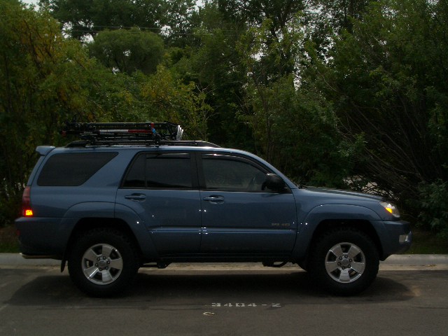

toytec topout spacer here is a pic of my old 04 SR5 with the topout spacers and 255/75/17 BFG mud terrains
