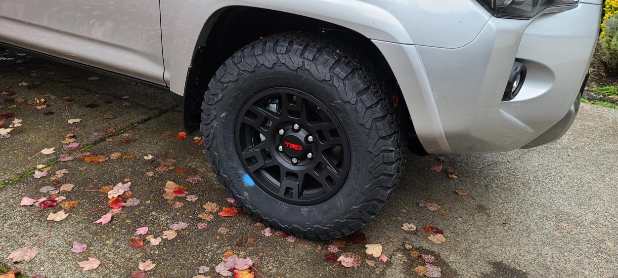

I did look at the TRD pro and it has stock 265. no where near what a 285 looks like but not too shabby. I just put on the 265 instead and will look into leveling the front if I cant live with the look.
I am not too concerned with lane departure but I definitely want to keep the collision avoidance aspect of the system.
So this is what it looks like now
Do you mind posting a full shot of your 4runner? Mine is also a silver TRDORP and am looking to go with the black Pro wheels for my 265 KO2s. Just want to see if it's worth it and tough to find "stock" pics
