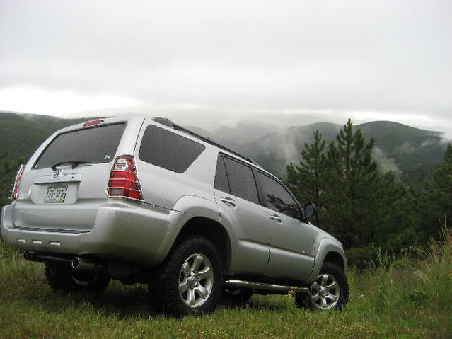

I started with 2/1 and didnt care for the rake, or lack there of, especially when I had the trailer on, so I upgraded to 2/2 and now I'm much happier!

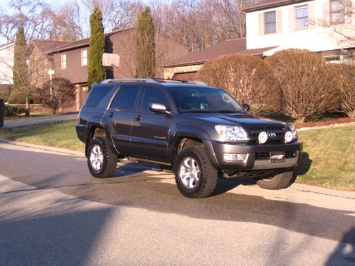

I have a pro comp 2.25" front level spacer and nothing in the rear but stock and the 07 is perfectly level! Very happy with it, even with a cargo load.... but when I get the $$$ I'll go with a 3" full suspension for sure
Danny seeing your truck makes me envious! My truck is the same color as yours, so its nice to see what it will eventually look like.

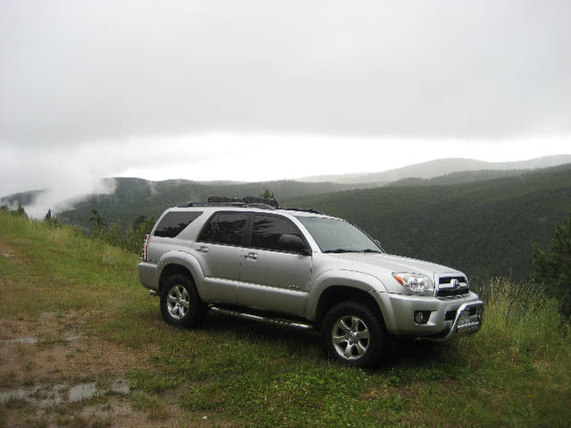

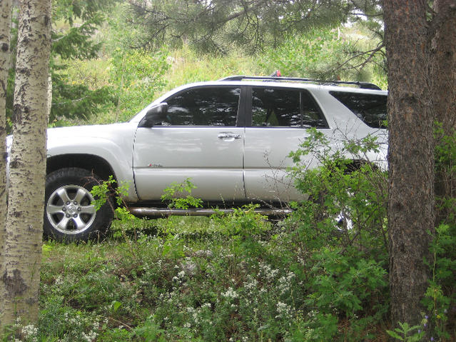

thanks for the kind words! good luck with the springs, i'd look into ToyTec if I were you. As far as the "maint light" I just had mine turned off. I had my mechanic do it but I bet Auto zone or checker can do it for free. Mine came on when I hit 36,000 miles.
