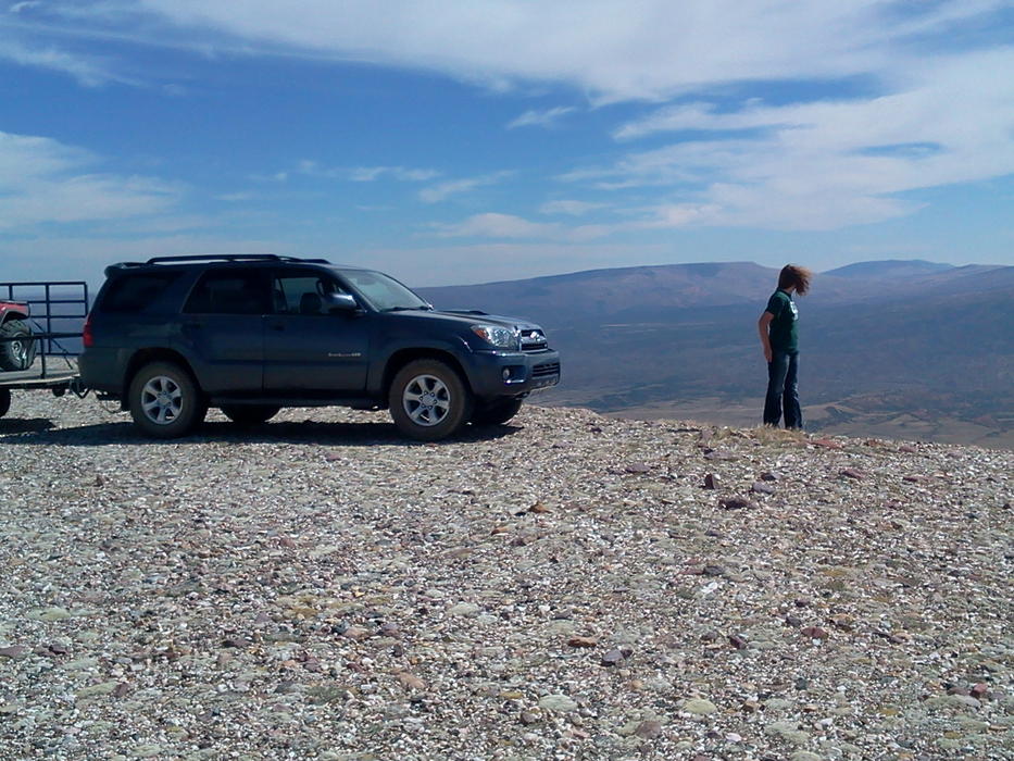

This is the little beast needing some clearance
The daystar lift sounds perfect for you.
It's 1.5 spacer in the rear, 2.5 in the front, it looks very level.
Here is right after we got the lift in:
Here's my truck (daystar) next to a stock 03. Same color and everything!
I could not be happier with it.
