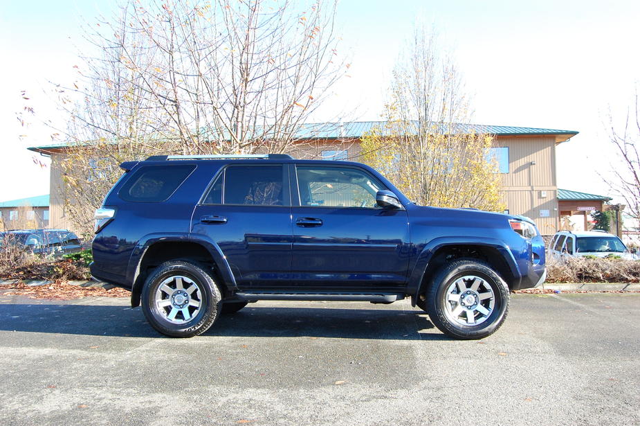

Just do all four in Bilstein, set your front to 1.75, and while you or someone else is underneath just have the 1" rear spacer installed. Many have reported reverse rake with 1.75 front and nothing rear when they have a load.
Here's mine 1.75 front and 1" rear spacer.
That looks great. Same color too. Are those the stock tire size (265/70)? Just tying to picture the look I'm going for.
All the above (is true)... You have to decide what type of ride you want, along with the desired stance. Just want to level only with a softer ride? Add a quick front spacer and be done with it. Want it to ride firmer? Go the Bilstein route and then decide how much lift you want... .85 front will leave you with slight rake but no more "squashed" look. 1.75 front and 1 inch rear spacer will look the same as .85/nothing, just a little higher/meaner.... 1.75 front/nothing rear will level your fenders, but leave about 1/4 negative frame rake. All of these settings will still look pretty much okay with stock size wheels/tires. [MENTION=131488]ST1FLER[/MENTION] set-up is the highest/meanest of the bunch... But I probably wouldn't recommend rolling that unless you are up-sizing your tires too. But hey, to each his own. It's your rig, do as you please. There are PLENTY of pics for every single one of these settings on here if you dig for them. Each member here likes different set-ups... I would find some pics and just go with what you like.
