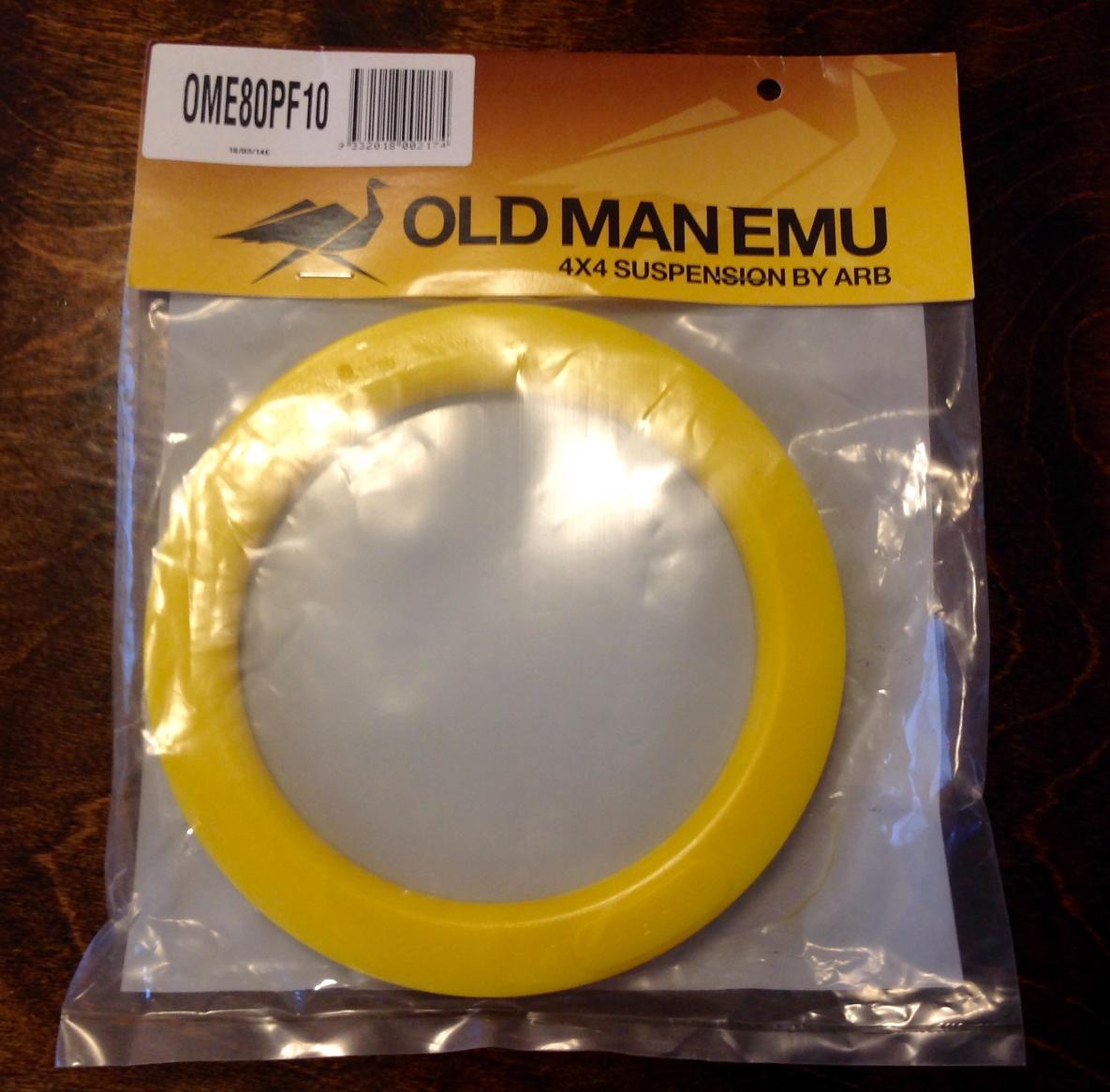

Sorry to slightly derail this thread, but if you want to fix that lean, I have a brand new 10mm poly spacer from Wheeler's off-road that I never used in my own lift install (bought it just in case but didn't need it) made for just this issue. Happy to send it free-of-charge if you could use it.
if he doesnt want it, ill take it!
