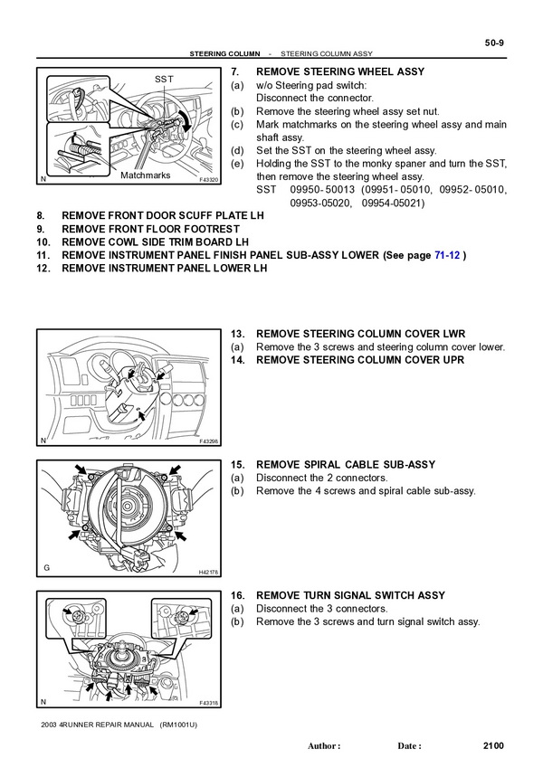

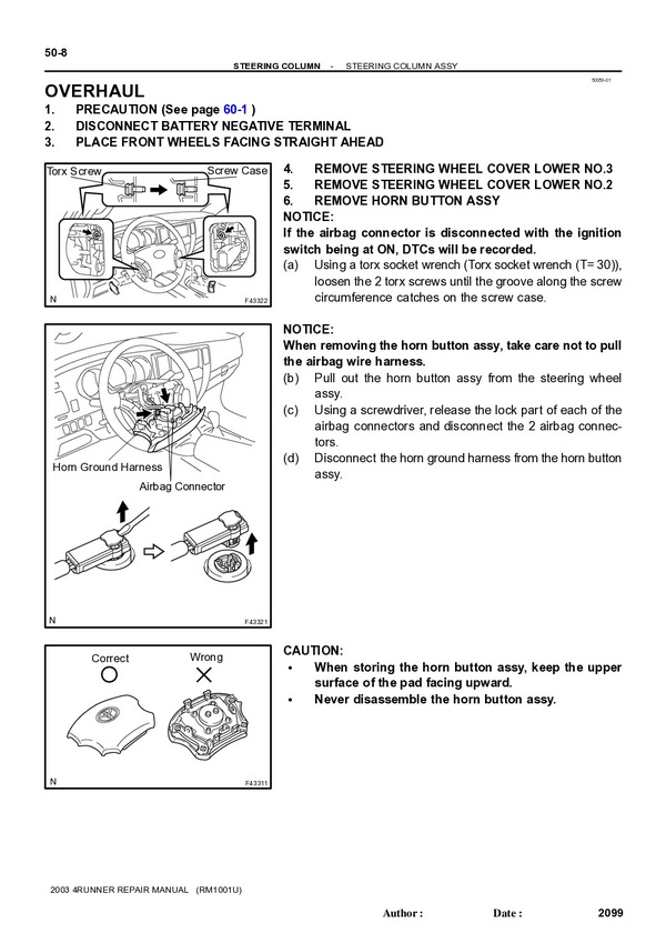

Ok, maybe it's too early in the morning or maybe I'm having a bad day but I have been trying (for the last 30 minutes) to search for the instructions and photos of how to remove the steering wheel on my 2003. I have read it over the past few days and for some reason am unable to locate it with the search function. Can anyone help? Thanks again.
If this will help you:
