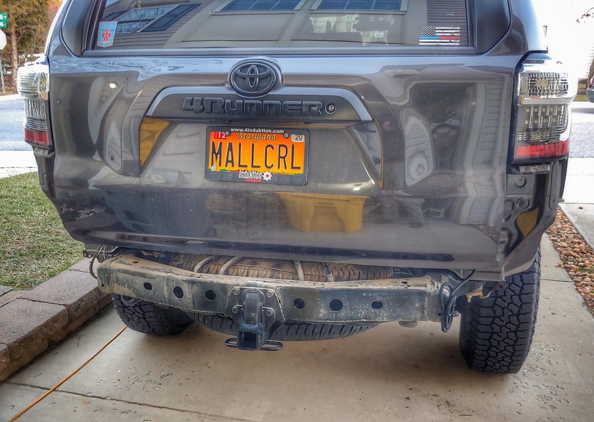

As a bit of backstory, I've looked at bumper options since basically the day I bought the truck (Sept. '18), but nothing really checked all the "want/need" boxes (these boxes are absolutely different for different people). Sometime in 2019 I saw LFD Off Road's rear bumper and while it happened to be open on my monitor, my girlfriend came in the office, looked at it and immediately said "oh, I really like that bumper!". Let's be real, if it checks all the boxes that's wonderful, but if it checks all the boxes and get's the approval of the other half, that basically makes it a done deal.
I ordered the bumper right around Black Friday with an initial lead time of about 4-6 weeks. Since LFD Off Road is about 7 hours South of me (and I drove ~6hrs South to have Apex Overland do the suspension/skids/snorkel last year), I told Jay@LFD to just hold on to the bumper instead of shipping and that I would come down to grab it. It should be said that I also ordered a gas tank skid at the same time, also for pickup (although, they were in stock when I ordered). Despite the holidays slowing down the process my bumper was completed right around the 6 week mark, and the following week (last week) we made the trek down to grab it. Jay's instructions were simply "arrive with no rear bumper and the exhaust pre-cut"... Easy enough to do, and we were off!

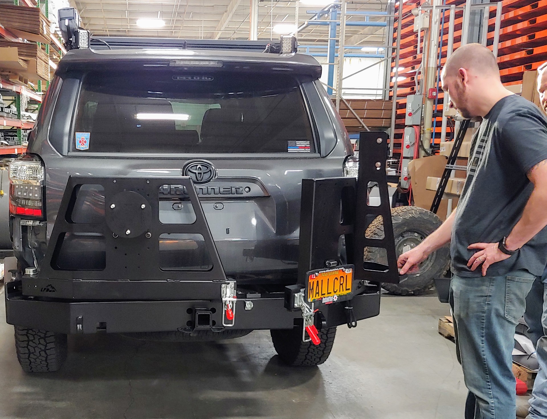

About 7 hours and a great lunch later (if you find yourself in Burlington, NC, try Danny's Cafe) we arrived at the headquarters (a substantial establishment that it is) of LFD Off-Road. To be greeted by a handful of decked out 5th Gen 4Runners (that's all we care about here, right?). If you're looking for other stuff, there's also a not-too-shabby 80 series, a Tundra, and a GX. We were also lucky enough to arrive just in time to see the first of the LFD Bed Rack's being installed on a 3rd gen Tacoma. We had met Jay at the T4R Experience in Kentucky last year, but were finally able to meet Phil & Mike. After a few minutes of chit-chat and a quick look around, it was time to make the back end look (kind of) complete again. Just a few days prior to my appointment @ LFD I had helped a buddy install a rear dual-swing bumper made by another company, and to be honest, had some concerns about starting on the truck in the late afternoon. Those fears were quickly quelled as in what seemed like just a few moments of conversation over 200lbs of steel had been added to the back of the truck.

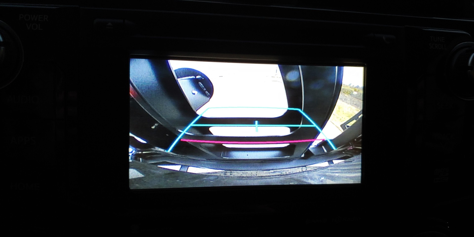

Not long after that photo was taken the final touches were done, latches adjusted and time to back out into the real world. OH! That's right, there's a tire carrier blocking the back up camera! This is a shot of what you can see through the OEM back up camera (obviously, without any relocation). You'll note that the tire is not on it, with the tire on it it blocks basically all view. More on this later.

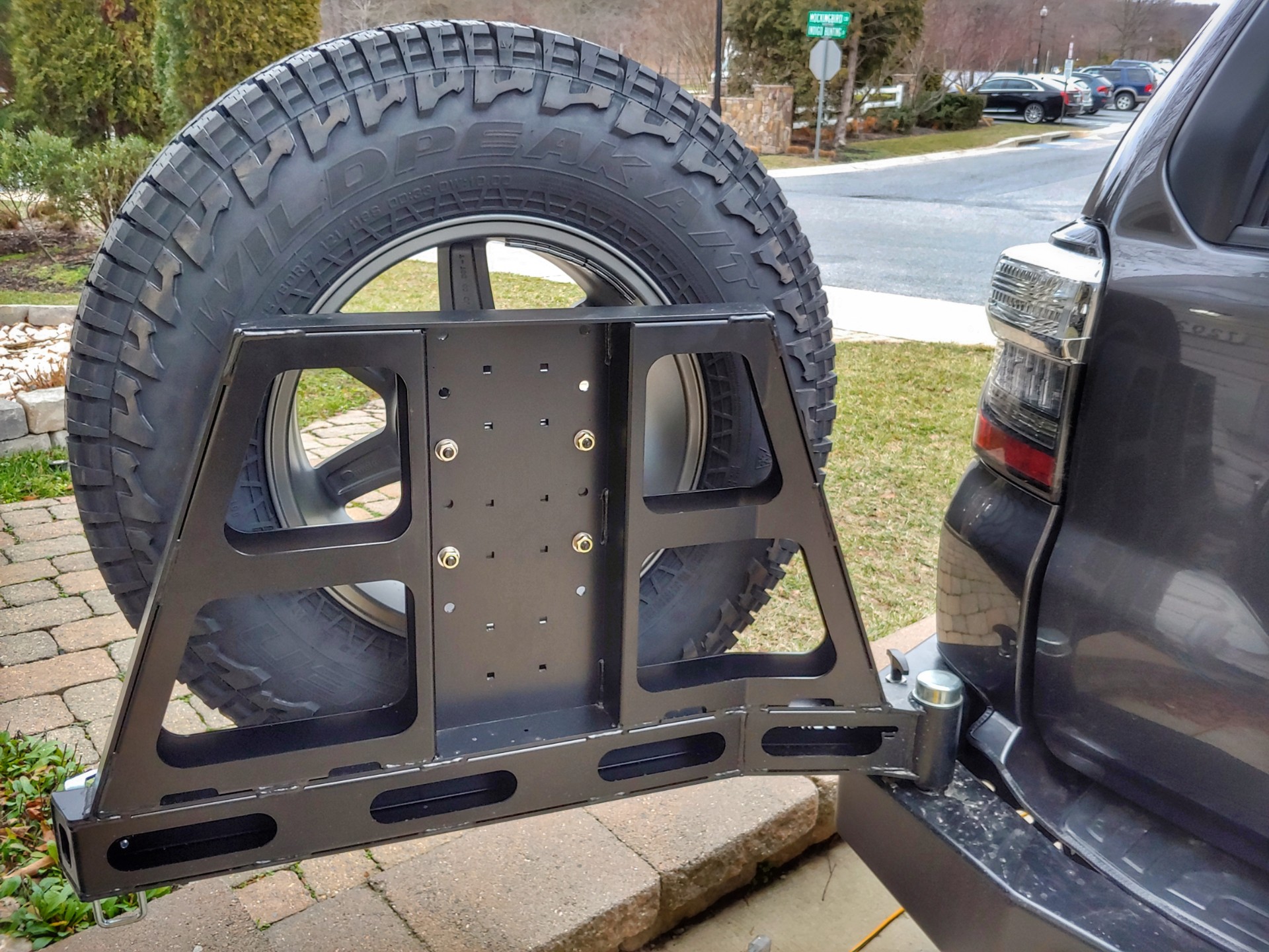

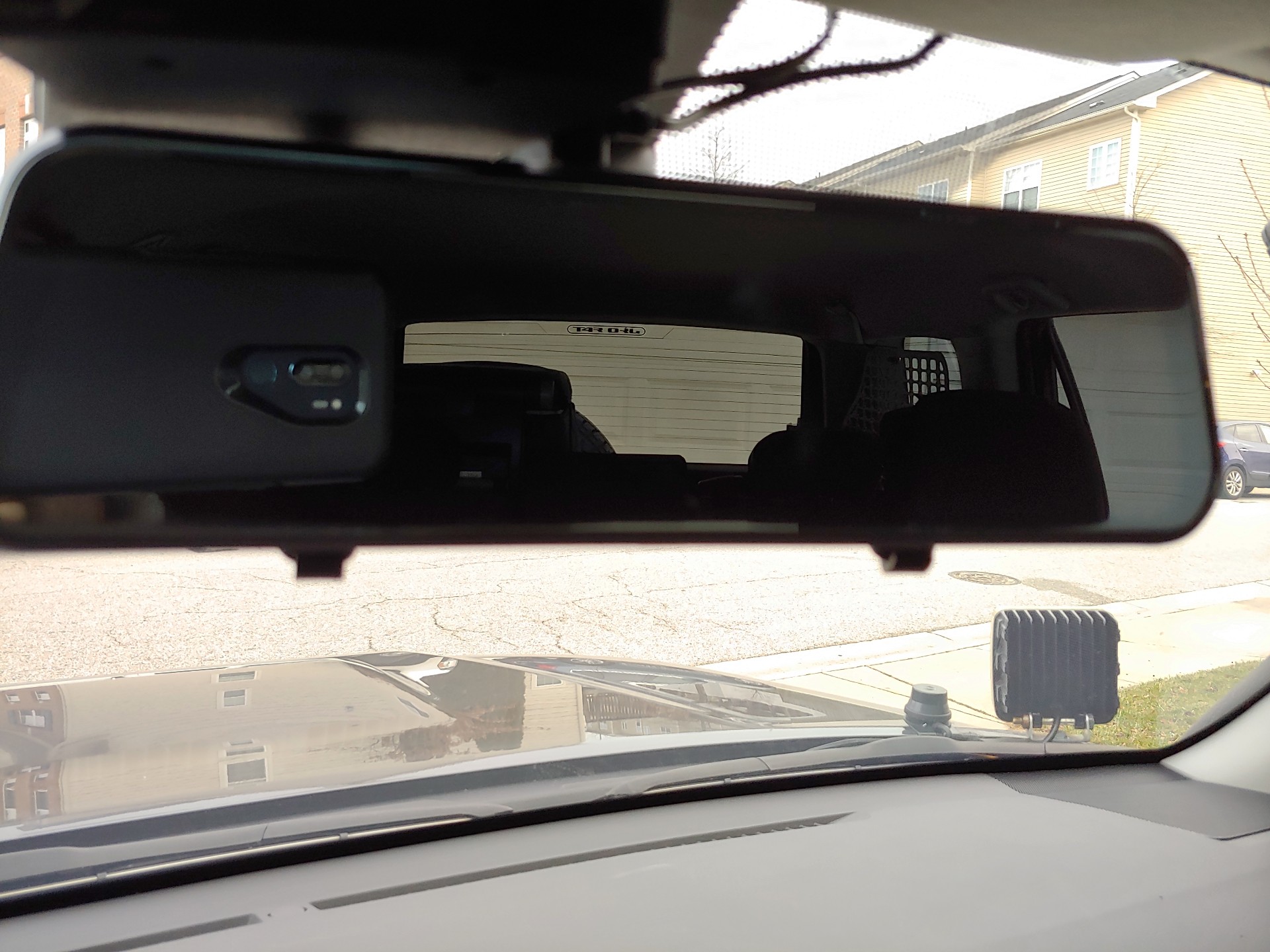

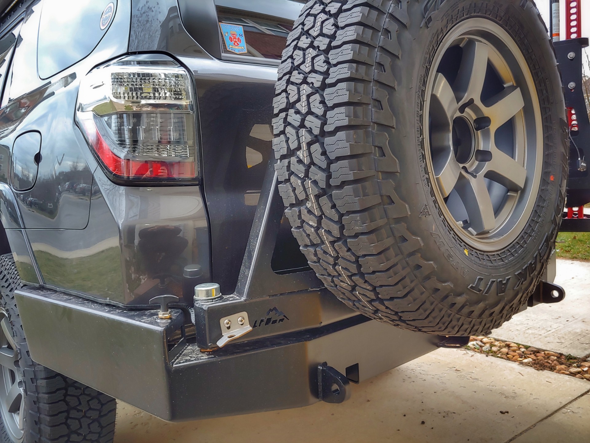

I have a ARB 50qt fridge on top of a shelf system in my cargo area, so part of my driver's side rear vision is obstructed already. The LFD Off-Road bumper allows you to mount the spare tire at a variety of heights, if I recall correctly, mine is two spots down from the highest position. Excuse the horrible photo, but it shows that the tire is barely visible. Popping both of these on were a breeze. Tire is self explanatory, and the hi-lift has a lock washer/nut combo to make sure it doesn't come loose driving down the road (as well as the same easy-off mounting included on the roof rack Hi-Lift mount for trail usage). With the "standard" hi-lift jack, the top of it becomes the tallest part of the truck, with Dobby 327 springs and 255/80s, that's right around 6'10".

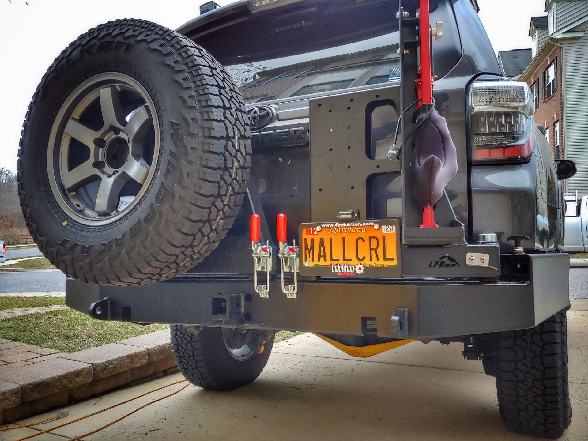

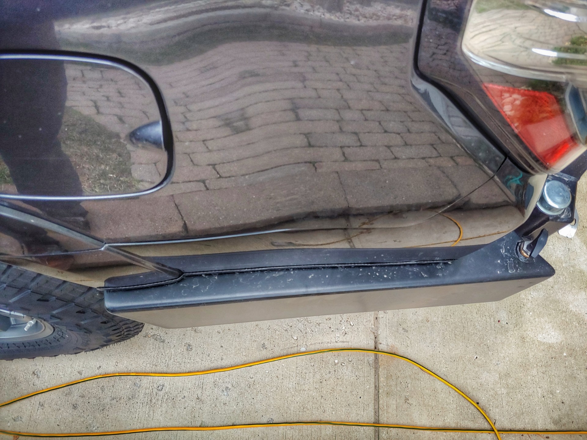

Over the weekend I took the required measurements and did a (less than professional) job of cutting the plastic rear bumper to fit, it's trimmed with some door trim. I think if it hadn't been in the low 40s, and we had a better blade, we could have taken more time and been more exacting with our cuts. However, it gets the job done, and from 10 ft the cuts look fine. Also excuse the horrible looking license plate light wiring, that was a quick solution I whipped up while LFD was installing the bumper, it will be re-run (appropriately) this week!

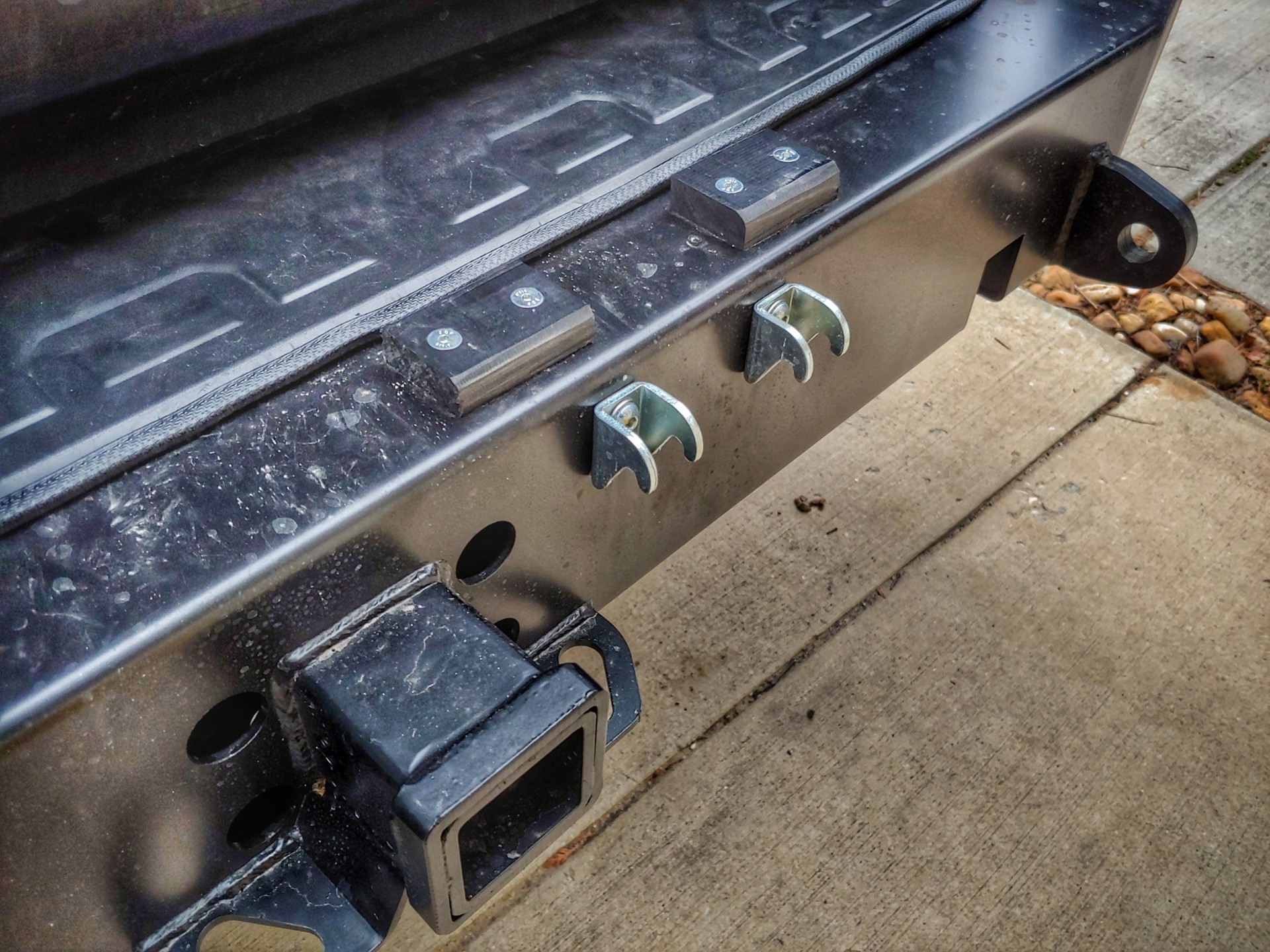

Now for what everyone wants to see, the up close pictures of the bumper! These were (obviously) taken in my driveway, not on some cool trail with picturesque backdrops. For amazing photos of this bumper like that you'll have to go see [MENTION=73851]007Tacoma[/MENTION]
Final (ehh?) thoughts/observations/etc -- The fit and finish of this bumper is only surpassed by the team behind it and all the other LFD Off Road products. It sounds sappy and like a pitched line, but it is absolutely the truth. Every interaction with everyone at LFD has been stellar. Thorough and clear communication, every step of the way, even when it isn't the best news (like "it's not going to be ready for when we initially hoped"). These guys will legitimately bend over backwards to make sure everything is right.

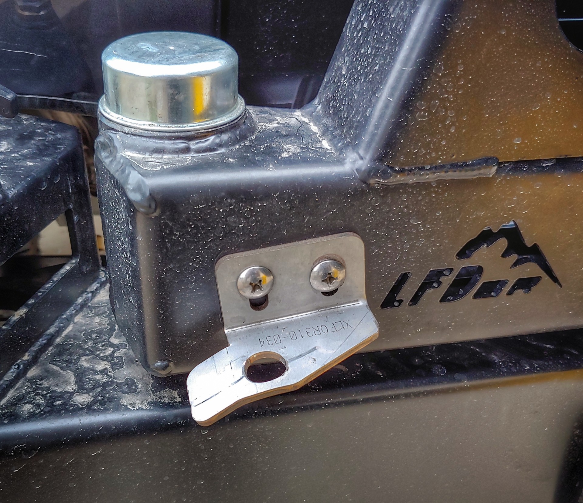

The thoughtful touches of the bumper just keep making themselves known; to list a few:

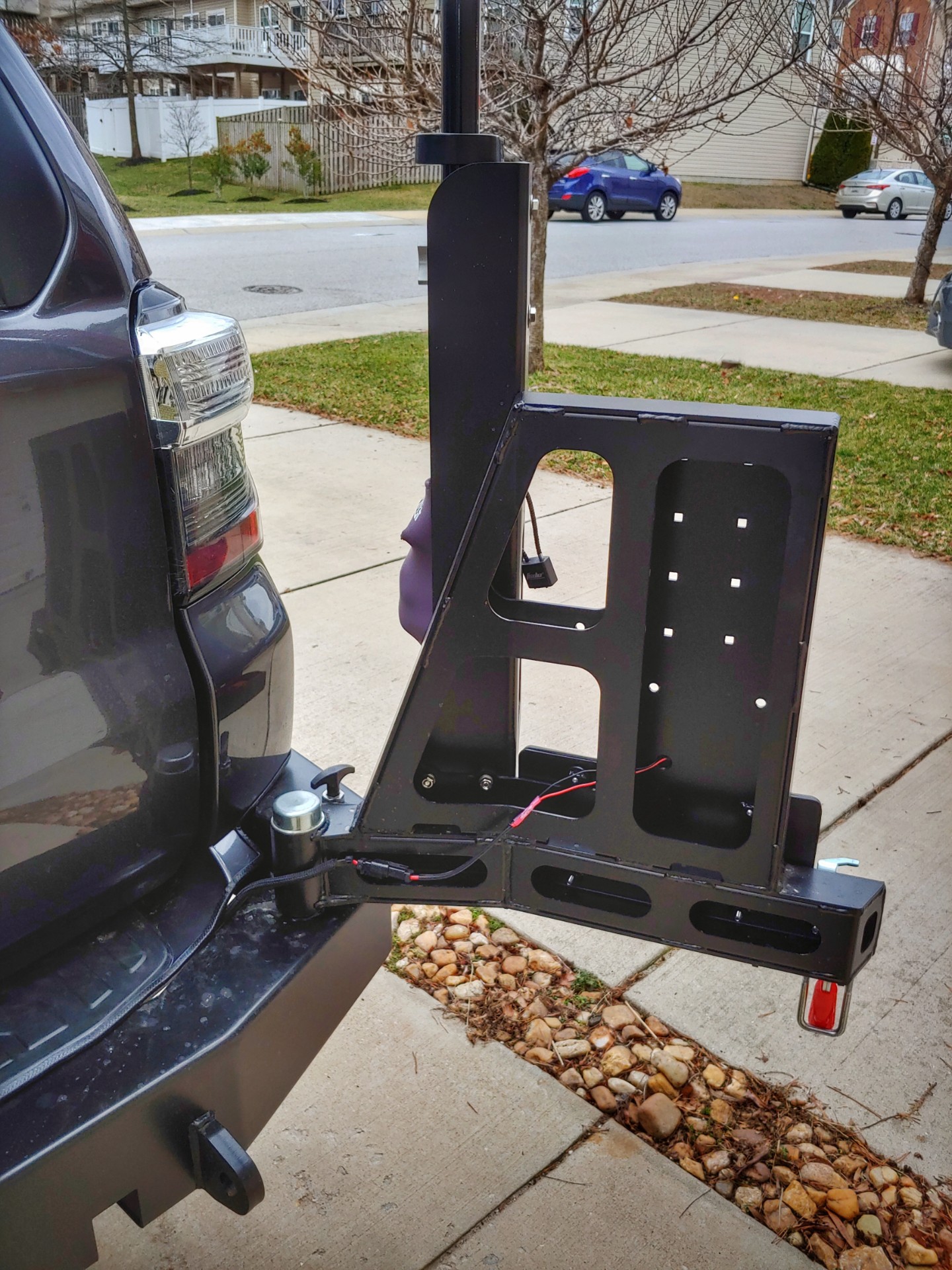

  • Stainless steel latches, so you don't have to worry about powder coat wearing off after hundreds of times of opening/closing the arms
  • Swing arms that are removable in minutes, to make daily life easier
  • Zip tie holes to hold wiring to the swing arms out of the way
  • Welded studs on the spare tire carrier so you don't have to fumble with lining studs up or holding a wrench on the backside while putting a tire on/off
  • Integrated Hi-Lift Jack lifting locations
  • Ridiculously strong rear recovery points (see this photo
  • Super quick install of all pieces/components
The weight of the bumper is substantial (as with any other steel dual swing arm bumper), and subsequently I've ordered a set of Dobinsons 329 springs to replace my current 327s. The 327s would have been fine if I was a little lower in the front (currently have 314 springs on 574 ET struts), but I miss the rake look.

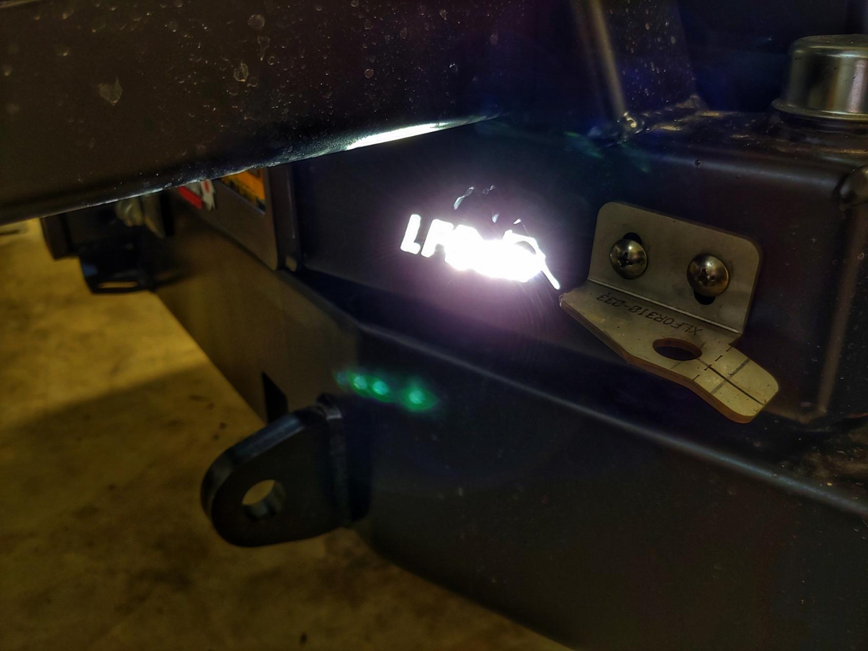

Second was a pair of Strobes'N'More X8 Trio LEDs installed in the swing outs. These shine through the LFD Off Road logo and serve three functions. They illuminate red for brake/turn signal, white for reverse/rear scene, and amber for a dust light. They don't throw a ton of white light (after all, it is a 180 degree optic, and especially not compared to the other 8 rear facing reverse lights), but the amber and red functions are very easily noticed. Mounting was done via the included (with the lighthead) bracket and some 3M VHB

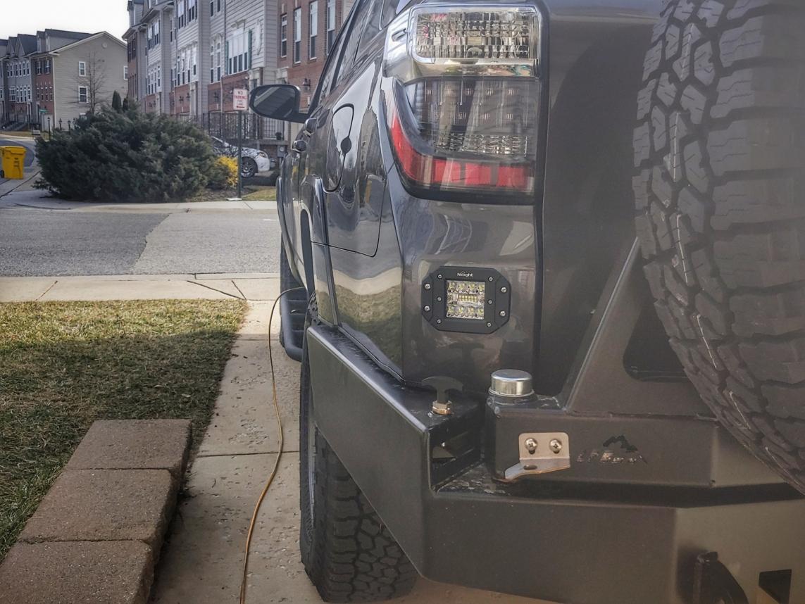

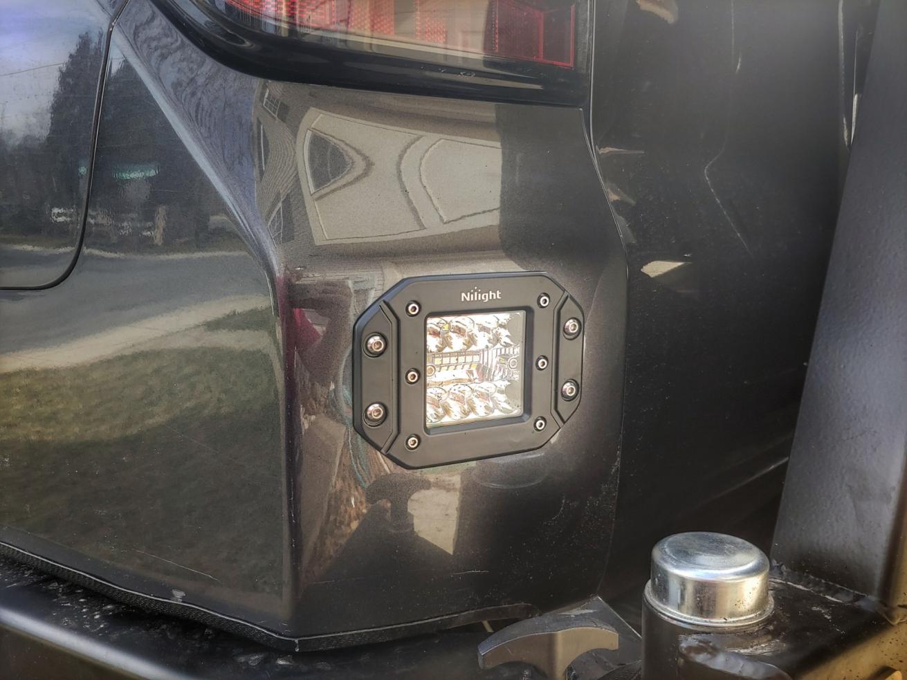

I mis-measured one of the cutouts for my in-bumper reverse lights and went too big, that has lead to me grabbing a set of "generic" flush mount floods that got installed yesterday. Next up is wiring up the backup camera!
Unfortunately, it seems like it'll be another two months before that happens... But then we'll have a week and a half on the GA Traverse...
I have a set of those that came out of my old bumper... I am doing my best to avoid installing them into my new LFD rear bumper... Looking at options today.
I was made the offer of including cutouts into the bumper at build time, but I skipped that... Yes they are $25 cheapos from Amazon, yes they will probably be dead in a year, but they put out a decent amount of light (probably not quite as much as my previous $120 lights that were less than 1/2 the size). With all that being said, I have 10 separate lights that illuminate when in reverse, I don't think a few candella here and there will make much difference
