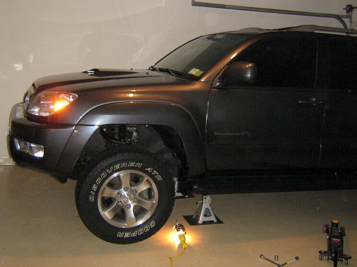

This is right before I started the job:

I didn't disconnect my XREAS. As you can see in the pic, the front shocks were at full extension (both sides on jackstands) when I removed them. The back was sitting on the ground under full weight. I just unbolted them one side at a time and had no issues whatsoever. I used a small milk crate to support the shock without putting any stress on the hydraulic line. Be forewarned----you do not have a lot of room to move the shock. Once it is free, you can pretty much only lay it down (on a milk crate, for example) because the hydraulic line isn't very long. But it can be done without a problem as long as you having something the appropriate height to support it.
