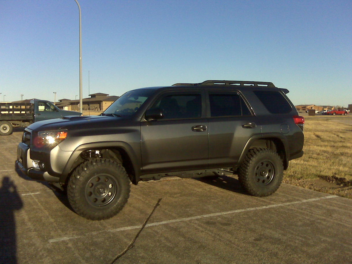

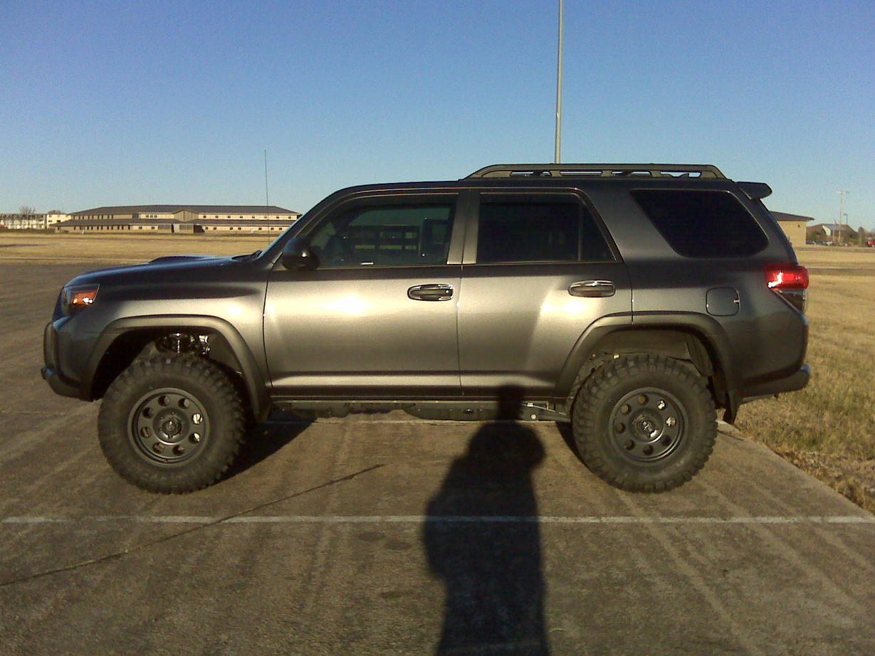

Here we go OME 844 coils and toytec top plate spacers rear is ToyTec superflex coils. The tires are 285/70/17 BFG KM2's

thanks it rides good and I also forgot to mention a big thanks to member Hawkdog21 for answering all my questions I actually haven't measured yet I got everything done and had to haul ass to work tonight
Okay, just so I understand, you are running both OME coils *and* the Toytec top plate spacers in the front? So I take it the OME coils for the front don't compensate for the 4runner's front rake, so you still needed the top plate spacers to keep things level?

jreiter you are correct the ome coils don't level it and you need top plate spacers to level it out or as toytec says a full 3 inchs.
