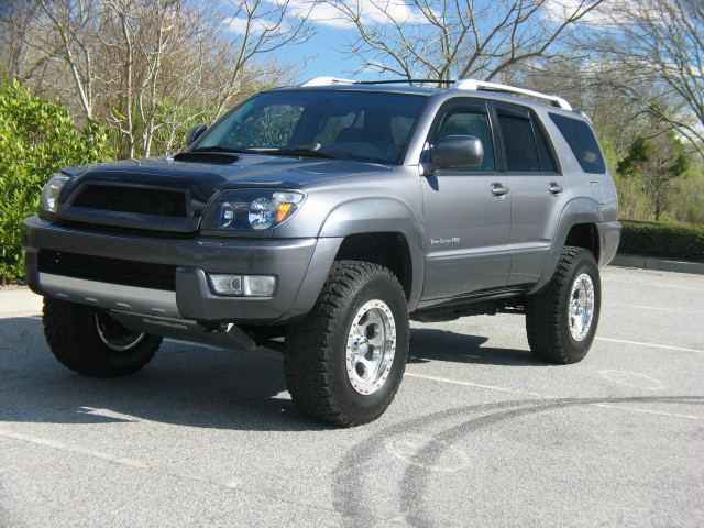

Lift Finished! Yeah!

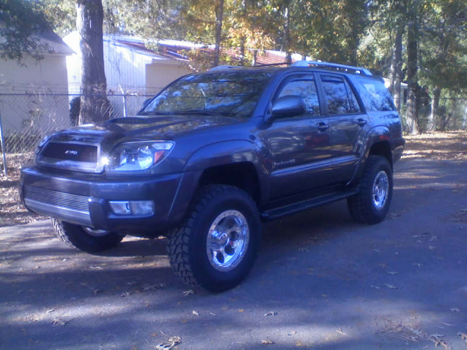

XREAS are gone, yeah! Here is a picture that I took with my cell phone today when I went down to the shop to see how my new wheels and tires looked. My neighbor and I installed the lift in my garage but I had a shop level it out because I didn't have the right tools for the coilovers. In this picture it still needs leveled out a little and an allignment. I had to remove the front mud flaps and had to do a little inner fender trimming up front. The shop I went to suggested that I let them notch out a small strip of the body mount with a plasma cutter. Where the front wheel rubs a little at full lock. They told me that they would weld a piece back after they notched it and paint it black, and they told me it wouldn't hurt the integrity of the vehichle. I told them that I would just let it rub a little for now, as it would barely rub turning out of parking spaces and such. I just gritted my teeth and said "cut what!" I will post some better pictures when I get it home. I'll probably replace the factory skid plate next and take off the bottom billet grill and sell it and go back to the bottom stock grill. What do you guys think so far?

It is a bit nose high in this picture. I told them to lower it one crank, which is only 1/8". I figured it will settle a little over time and with the little extra weight from the skidplate that I will be adding and with two people in it, it will level out better. It was hard for me to get the truck perfectly level as it comes from the factory unlevel from left to right. Dialing in equal amounts of cranks on left/right coilovers just would not work. One coilover is cranked down 1/4" more than the other. I did a bunch of asking around and everybody has told me the same thing. Also, the shape of the 4th gens. fender well is not very "big tire" friendly either. The 33's would of worked better with a more round fender well, but.....I love the way it feels and drives much better now and would never go back to the XREAS after riding around in this. Feels more like a truck now!!
I did measure it, but I would feel much more comfortable if you would come over and measure it for me with your P-34 space modulator. ROFLMAO! Only joking. Don't go nuts on me now, lol. I would like to add, that IMO, the 4Runner does handle better in some situations and not as well in others. It sure doesn't take high speed turns as nice and crisp as it used to, but that doesn't matter to me because I didn't want a Corvette, I wanted a truck and I don't intend to drive it at high speeds. The acceleration is not as peppy as stock due to the big tires changing the gearing. As far as going over pot holes and and bumpy roads at high speeds, yes, it absorbs the shock much better than stock. The truck no longer nose dives when coming to a stop now, which i love. With my wheel offset at -12, it gives it a wider stance and "helps" compensate for the height. The wide tires helped a little for handling at high speeds when driving in a "straight line", but not as well at high speed quick monuvering. I guess it just depends on what kind of performance you looking to get out of your vehicle.

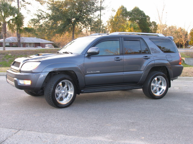

Here is a picture of my 4Runner when it used to be set up with 20" wheels and low profile tires, but I really didn't like the hard ride that I got from the tires. I thought I would end up keeping it strictly for street use but I felt like I wasn't getting the most out of the 4Runner by having it set up like this so I set it up for the trails and I am glad that I did. I will never put that small of a tire on a truck again. These tires/wheels are for sale too. The wheels were purchased from the Dealership. They were a stock wheel that came on some of the Tundra's. They are Enkei Deep Six style. The tires are Toyo Proxes ST 295/45/20. They both have about 13k on them. The tires were nice for high speed cornering and good in the rain.

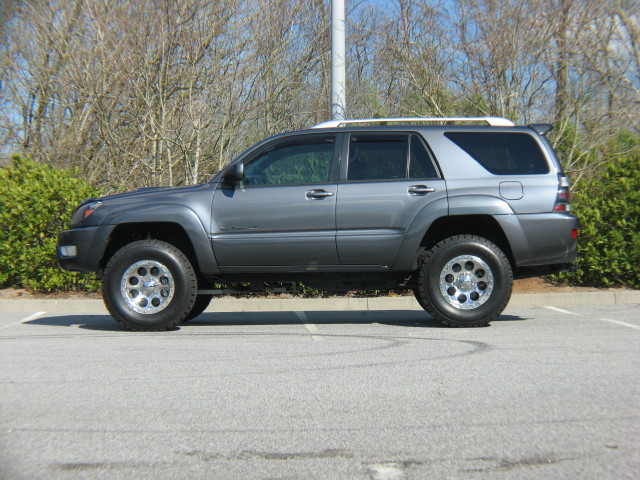

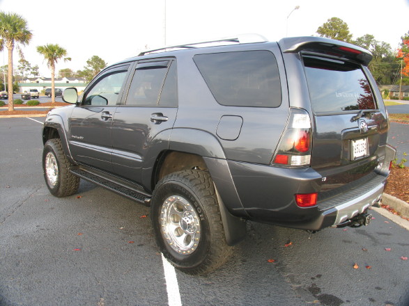

Here are a few new pictures I took today. I still think it sits a bit to high in the front end.

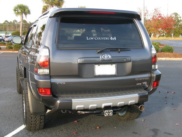

I sure don't like the rear mud flaps, thinking of loosing them, but they are good paint savers. hmmm....

Do you guys think it is nose high? Do you think the weight of a Budbuilt skidplate/bellypan would bring it down any, or no? The entire thing weighs around 100 to 120 lbs. I'm thinking one more turn on the coilovers, hmmm....

Beanz said:
Do you guys think it is nose high? Do you think the weight of a Downey skid plate would bring it down any, or no? I'm thinking one more turn on the coilovers, hmmm....
It is maybe just a little bit high, but barely. The Downey may be enough to get it down a bit. Great looking truck!

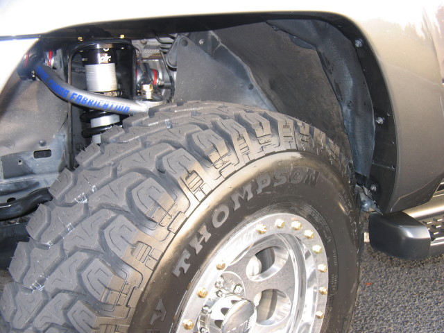

Thanks for the compliment Pro Med. I don't know if you can see it, but here is where some trimming to the fender was done, by the running board. It is not very noticeable.
