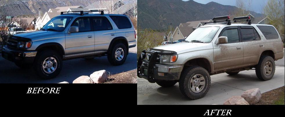

I installed a 2.5in daystar spacer lift a few months ago. It was very cheap ($425 out the door) and did what it was supposed to do...lifted my vehicle. I am still very happy with it, although I wish i had waited a little longer and went ahead with the 3in. Toytec lift. The ride is indeed a bit stiffer like ronMaiden had said, it does pre-compress the coil giving less articulation, and more stiffness in the ride, but i tend to like the way it handles a bit better than stock. I don't do too much offroading (the occasional road up to the campsites, bike trails, etc..) and it handles just fine for my taste. To wrap it all up though, spacers are great if your looking for a cheap way to lift your runner and like you said, give it a beefier look.

yea, here's before and after
