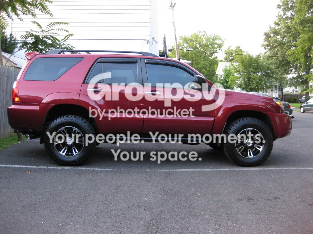

this is with my front adj. coilovers set for 2in. lift, it measures 36 from ground to wheel well, i have airlift 1000 rear bags & filled all the way put the rear measurement at 37. thats on the passenger side like the photo, so this should give you some idea of the how high a front only lift you can do & still maintain a rake. the tires are 265/70/17, about 32in. & i still had to move the inner plastic fender forward.
parkinglotafterwash003.jpg~original
front wheel is slightly turned, but you get the idea, any more agressive , larger, or MT tire might even need more trimming.
