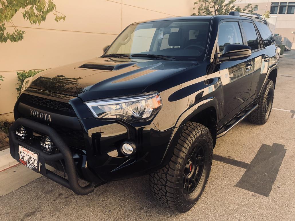

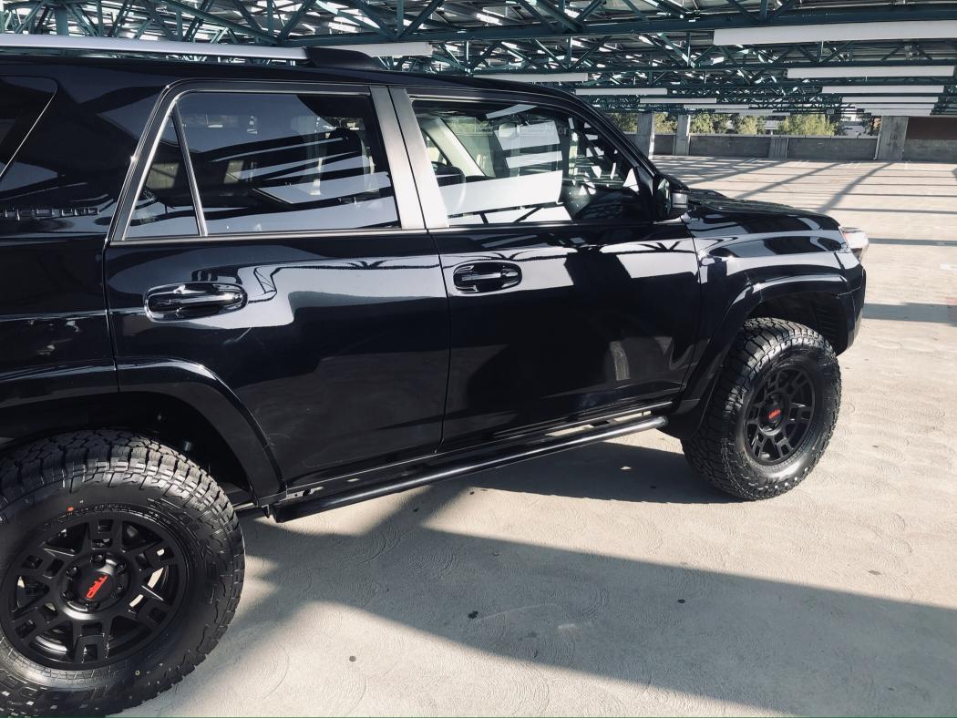

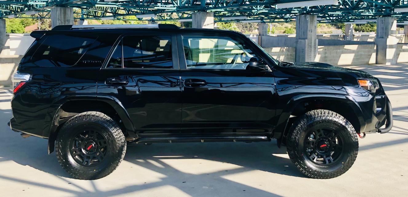

I’ve been running Jason’s 1.5/1” Cornfed spacers for almost 18 months now. No issues. Just stepped up last week to 285/70-17’s a week ago without any mods or clearance issues at light to moderate articulation. I like that it looks like a large factory Pro. I think the 2/1.5” is probably the perfect place to start, but, I am very happy that I did not have to upgrade. The Pro fender liner/bumper mod combined with the Pros 7” wheel and offset, seems to negate a lot of clearance issues. I wouldn’t run wheel spacers for several reasons, and the 285 fills out the wheel well perfectly on the Pro, IMO.

Holy crap that's GORGEOUS!!!
