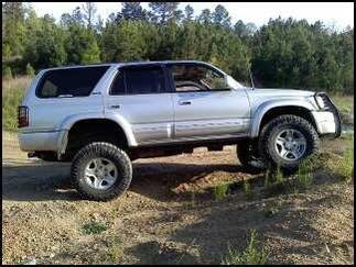

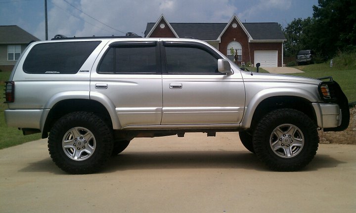

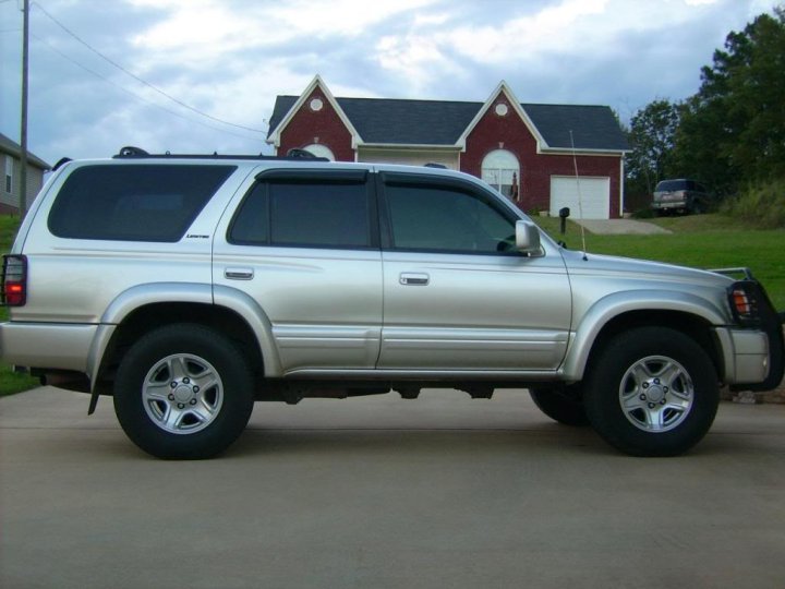

I lifted my 2000 2wd w/ the OME complete kit w/ shocks from ToyTec Lifts. I went with the 881s + top plate spacer in front and 890s in the rear. I love the way it looks bc it is nice and level. The ride is definitely stiffer but not too bad. I went from 33 1/2" in the front and 34 1/4" in the back (ground to fender measurements) to just shy of 39" after lift all around.
Here's a couple pics (first before, then after, then fun):

Did you have to drop the diff? Also, what size tire were you able to fit once you lifted without rubbing?
Well...
#1. This thread is 4 years old so I wouldn't expect a response.
#2. This thread is discussing lifting 2wd, sooo they wouldnt have to drop the diff since they don't have one.

what is the website you got the lift from?
This is beautiful and exactly what we (my son and I) want his 2002 4Runner to look like. Can you please tell me where you got the parts to do this?
I believe the poster said they got the complete set up from Toy Tec Lifts. That lift is approaching the higher end of lifting the 3rd gen. Do some reading and see if that is something you want or need. There are some inherent problems that can arise from lifting too much.
