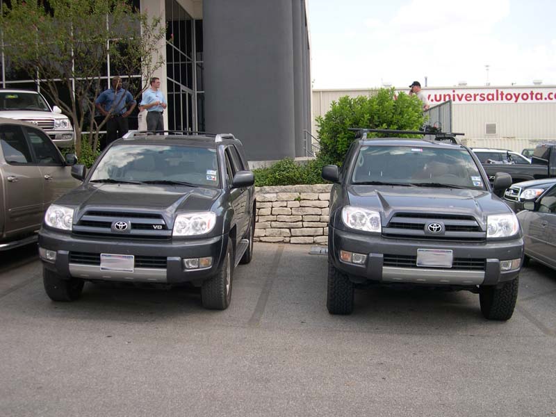

Took it to the dealer down the road and turned a few heads. Had to find another 4Runner to compare side to side with. This picture really doesn't do it justice.

its because your on unlevel surface
I can tell the difference. Your T4R look taller. Do you have picture which lighter the gap of the the wheel well?
I am so tempting to order the lift now. Mine only 3 days old. I want to wait for couple months to see how the 4runner drive and to see if any issue arise.
