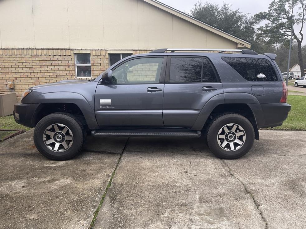

On my `05 I went with Front TRD Pro Fox coilovers, EMU upper control arms and Fox 2.0 Rear shocks. Daystar Front leveling kit. Also went with CK 6x5.5 Centric wheel spacers for a wider stance. Night and day difference in my opine. A respectable lift that's good enough for me.
