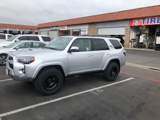

Hey all, I am new here and not sure if this is the best thread to ask this on but I have 275/70/17 k02s on a stock kdss and the wheels are rubbing on the front fender and rear body mount. Does anyone know if the 5100 Bilstein 0.85 will alleviate this ( I wouldn't mind leveling out the rake) and also would this be compatible with the KDSS? Thanks for your help.
Your wheels look like they stick out more than stock, which is likely the source of your rubbing issues when turning. If you have wheel spacers, try removing them.
No problem installing Bilstein 5100s at any available height, including 0.85". They will be compatible with KDSS, but likely won't have much effect on your rubbing issues.
