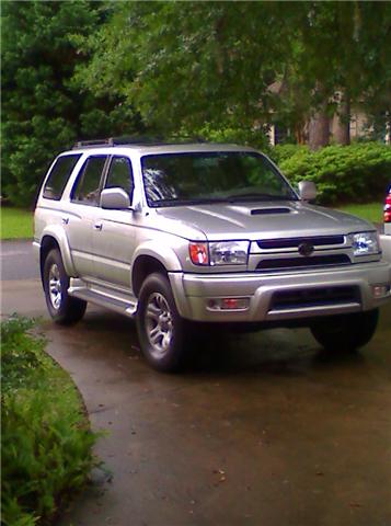

Thank you both for your help, I hope to get this done within the next week or two but here is a before picture.
Not great. Its a cell phone pic and also before the running boards came off

Looks like you've got a really sweet foundation to built from! I love the scoop, the grill, and the color! Definately post up the after pics, and make sure you get some Side Profile shots too!!
Again, great ride! Good luck!
