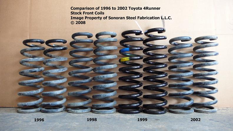

is it okay for me to run a 3in spacer since i have a 96 with the smaller coils compared to lets say a 99 highlander.
or should i stay with 2.5's?

this is off sonorasteel... this is why i ask these questions
