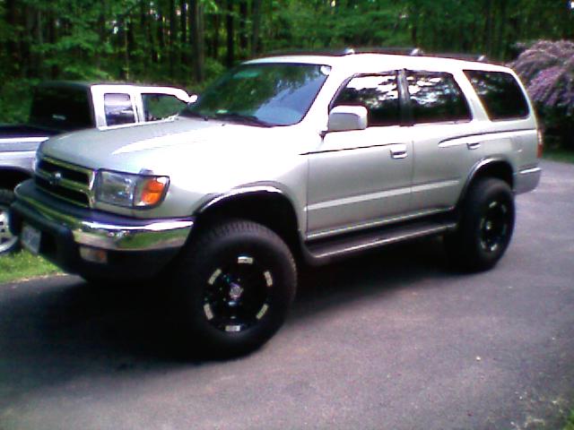

i've had a coil spacer lift on my 99 for 3 years new and have gone thru 2 cv axles(boot had broke). when i replaced mine i went with new ones with heavy duty boots. since then i haven't had any problems. oh and at 60 it doesn't necessarily vibrate, but rides more like a truck. i've been off road more than a few times as well, nothing extreme, but i haven't had any problems. coil suspensions are my favorite but i couldn't complain at the price. i can say, it was worth it
