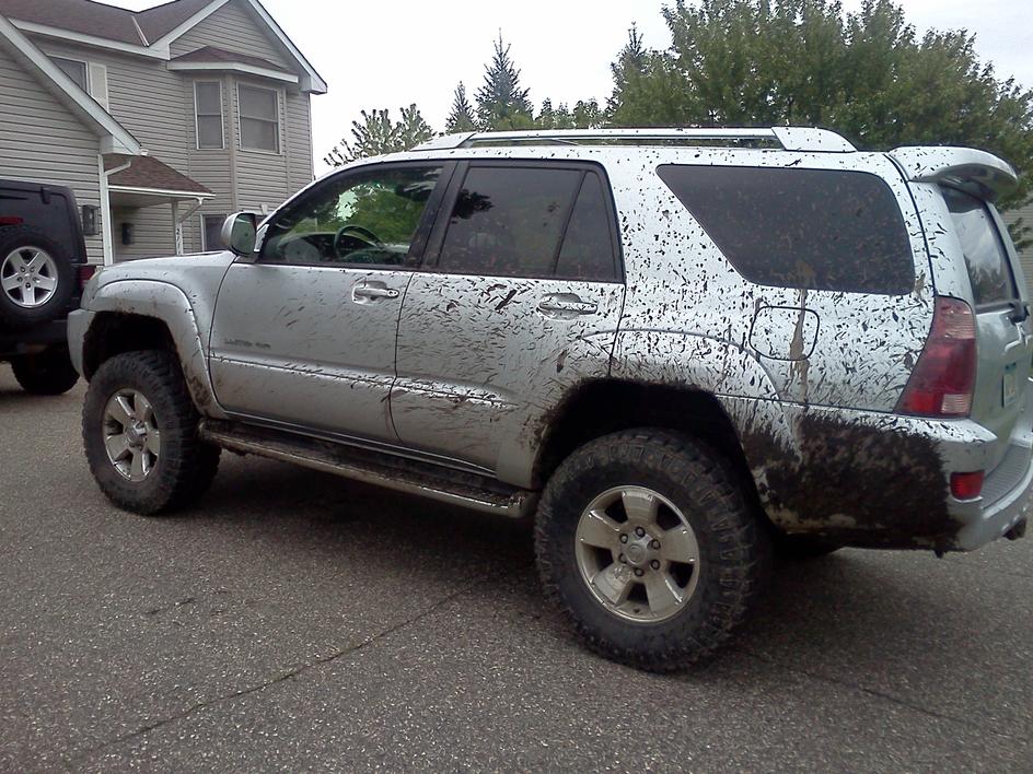

2003 Runner V8 added Toytec ult 3" lift pkg..(It's great ) Need help help with wheels!! I removed the factory wheels & spacers. I installed Some Rhino 9 X 17 I own a full set of Goodyear Duratrac 285X17 They rub on the driver side frame...
Anyone have this problem? any ideas for fitment & offset or whell ideas ?
Pic is with the tires& OEM wheels
Thanks

your car is squatting alot in the back, you could try lowering the coilovers so it reduces the angle of the body mount where your tire is running. i had the same problem and i added a 1" spacer and have no issues with a 285 i could even run a 35" tire, not to mention it looks a hell of a lot better with those coilovers jacked up and the back lifted 3"
