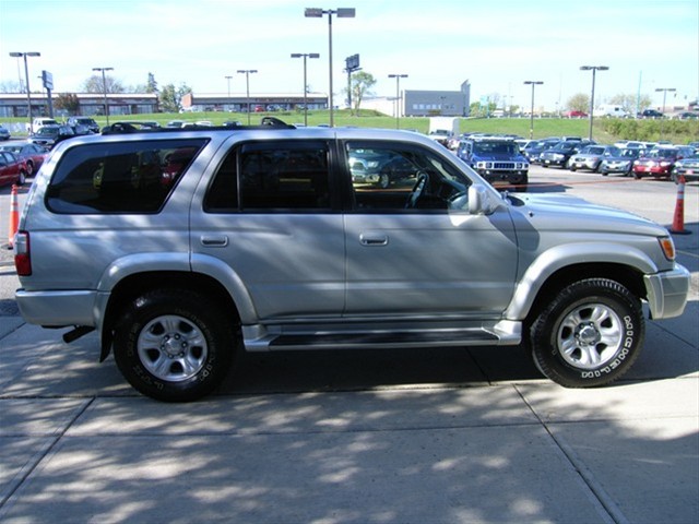

Here is my 2001 Sport 4WD. It seems to sit really low in the front and especially now since removing the spare tire(original) and the hitch. I don't know whether to: 1. Get 99 springs all the way around with new struts/shocks and then add a small spacer lift. 2. Keep the coils i have and get the Bilstein 5100s up front and replace the rear shocks and add a small spacer lift to the rear.
I am on a tight budget and like anyone else want the best bang for the buck. I don't offroad hard just camp, fish and maybe some light trails but I definitely want some ground clearance. I am running Michelin 265/70/16s.

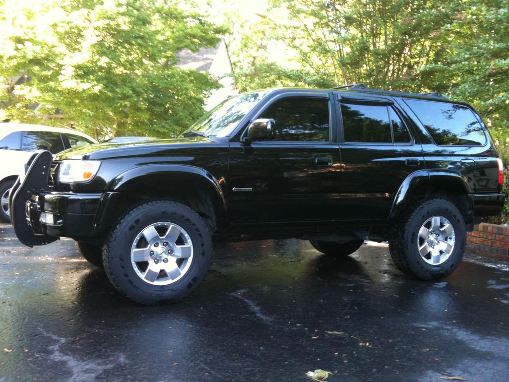

I have basically the same truck but an 02'.
I have a 3" lift kit, OME coils (883 front 891 rear) with a diff drop.
Running 255/75R-17 Wrangler Silent Armour tires.
I mainly camp/fish/light trails also and this set up seems to be perfect for me and rides just fine on the road.
