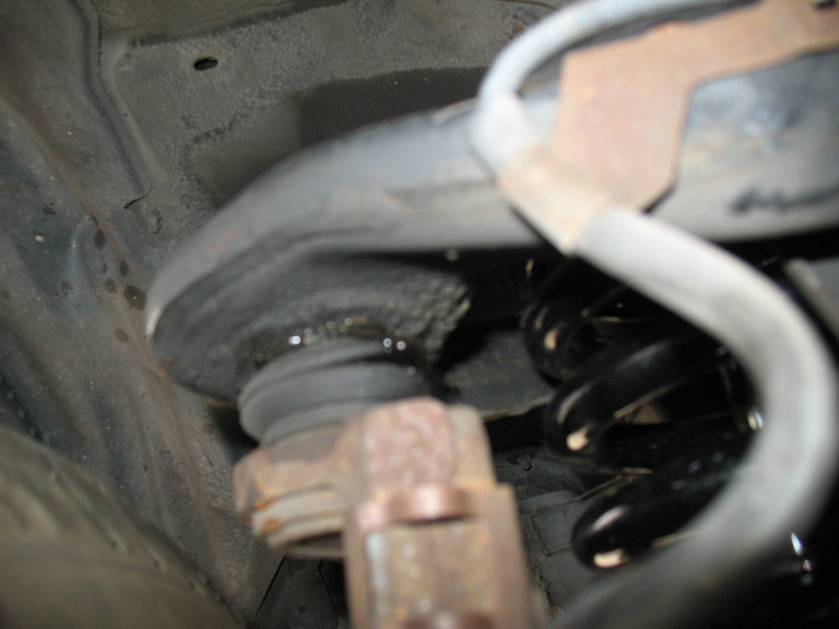

I have attached a couple of photos to help out. I am more of a visual person. The last picture is of a leaky upper ball joint.

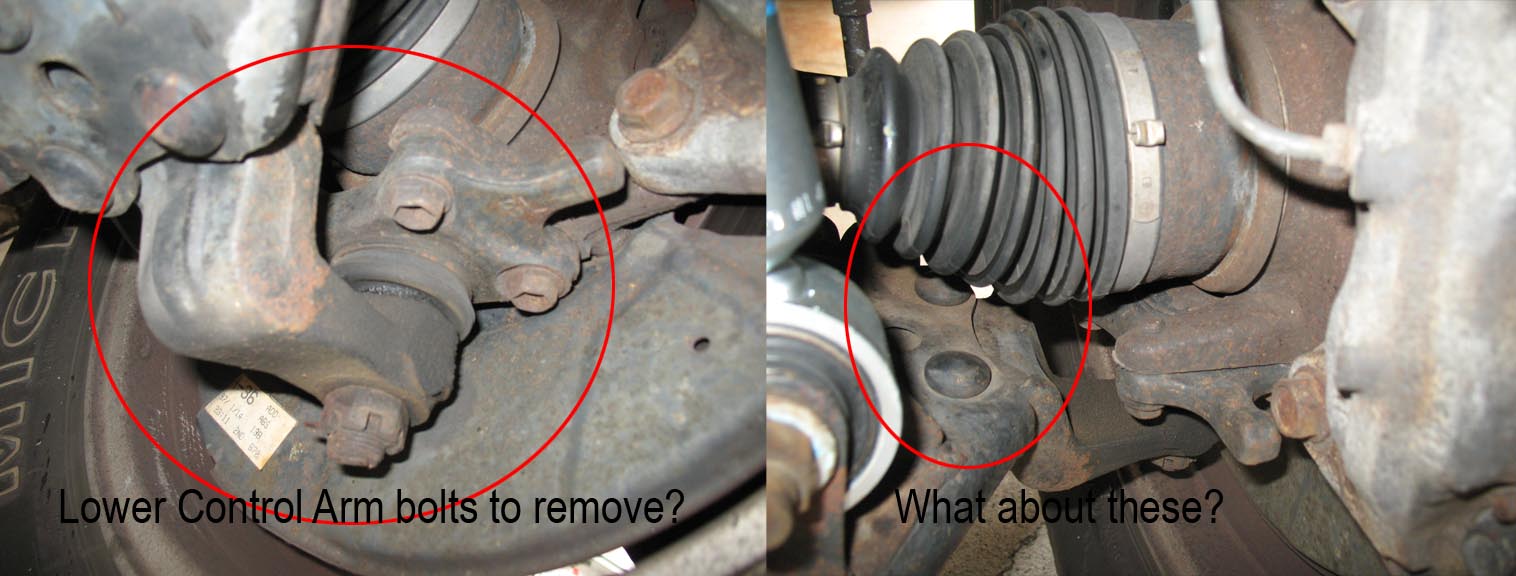

1. Lower ball joint removal. I see the 4 nuts, castle nut, and nuts attached to steering rod. Are those the only nuts to remove, before being able to take out the LBJ? From the photo there are some nuts I can't figure out how to get out, are they there for alignment? Besides those different fittings/nuts this seems like an easy bolt off/on job. Is it really though?

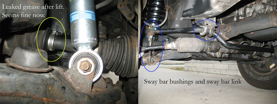

2. Sway bar bushing/link replacement. From the photo I have taken this also seems like a bolt off/on job. Any unseen hurdles from your guys past experience?
3. Upper control arms. I have read this is a pain to replace. So I will get the shop to do this one. But if I have to pay for install of upper ball joint and bushing. I would rather just get an aftermarket UCA. I know in the future I'll be interested in bigger wheels.

Most definitely do the swaybar bushings yourself....very easy and cheap.
Yes, that's everything for the LBJs.
Never messed with those, you shouldn't have to either.
Easy peezy. DIY.

I don't have any 1st hand experience with these, I'm still running my stock upper and lower control arms. But, control arm kits are very pricey and you will save a lot of money if you just do your UBJs and keep running your stock control arms. The aftermarket arms are cool, but if you're not running fast in the desert on a regular basis, they aren't necessary. Lots of people run 35s with stock arms and you're not going to run a larger tire than that without major mods to the fenders/body.

The SS1.2 comes with a diff drop so his shop should have already installed it. As for upper control arms I would go with the SS shaved UCA you don't get the extra droop that a uniball UCA gives but then again you don't have to run limiting straps to save your cv's. It really depends on how you will use your truck. If your not looking to bomb across the desert every weekend then the shaved are a great way to go and they will save you some money. Good luck

brian2sun: I'm starting to have second thoughts on those control arms. You and Rockdawg84 have me thinking about calling Steve at Sonoran Steel and just getting the shaved UCA's. That would help save some money and be ready for larger tires in the future. And as far as the LBJ, I'll be ordering parts on Friday and make a decision about installing after seeing the new parts. Thanks.
