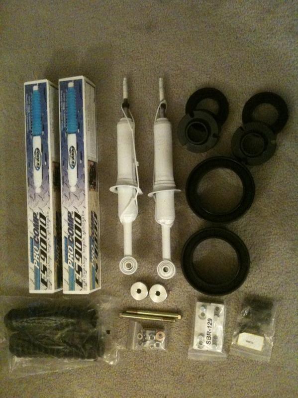

I just got the last of the parts I ordered to do my lift! I`m using a daystar 6 piece 2.5 front/1.5 rear ( Thanks again Falls! ), pro comp es6000 struts in the front, pro comp es9000 extended shocks in the rear, and a diff drop and sway bar relocate kit from toytec for some peace of mind! I can`t wait!

Are you going to use stock springs ?

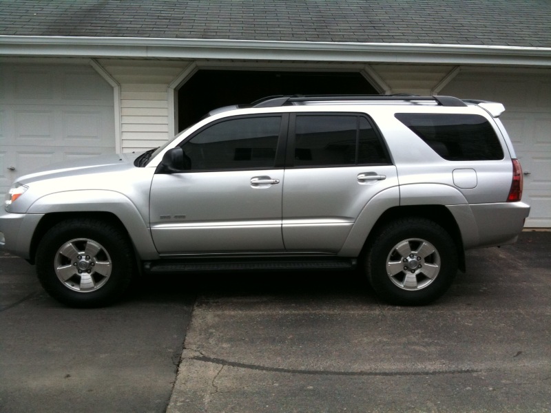

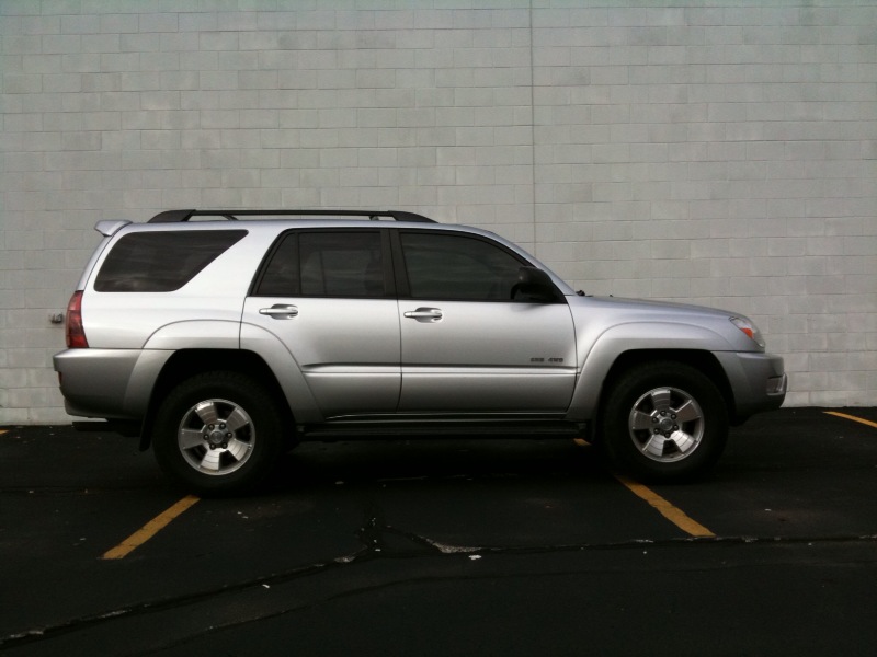

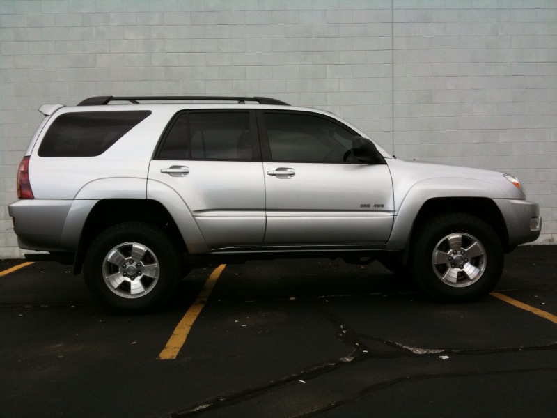

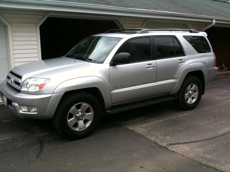

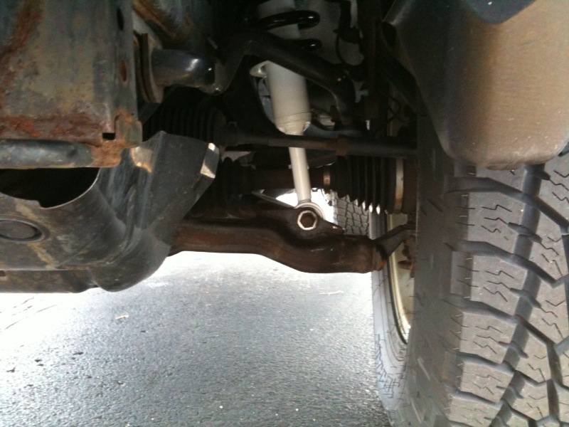

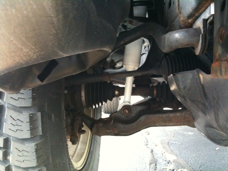

Got the lift done today! It took 5 1/2 hours, it all went pretty smooth. The pro comp shocks and struts ride just as smooth as the factory ones, but they take larger bumps better. All in all I think it handles better! The 2.5in lift with the 1in diff drop left the front cv joints completly straight! The first pic is before and second pic is after!

:bigok: Looks great!:dancin:
Yeh, those CV angles are about as straight as you can get... That's a nice report on the ride quality of the ProComps.
