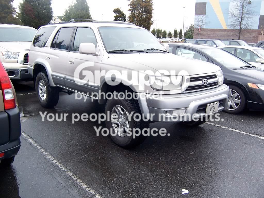

Hey guys, its been a while since I've posted and I have finally decided on lifting my 99' ~2-3"
First off my questions that I have regarding lifts...
1- I understand that the 99' 4wd models made in Japan with 16'' alloys came with the tallest coils from the factory.
1a- With that being said, throwing on a 2 1/2" spacer kit would actually lift my 4runner higher than other models making alignment issues arise, cv-boots etc.... therefore a 1'' spacer kit would be best and would actually lift my 4runner equal to the height that a pre-post 99' model with a 2 1/2" kit... correct.?
2- IMHO new front coilovers / rear coils would be the best, but just not going to drop that kind of money.
My 4runner has 180k miles on it, so I believe that the coils are a little soft, and a it rolls/dives like a 4door caddy...so a spacer lift would prolly make the truck ride better.

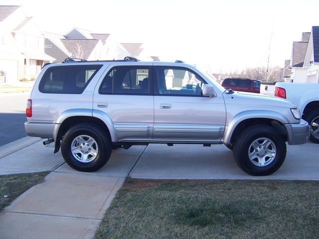

Last question...from all of your opinions by the pictures does the coils have enough sag in them to use the 2 1/2" kit with diff drop, or should I just stick with a 1" spacer...
Bone Stock with 265/75 16's and 180k on the odometer
If those are the original coils/shocks I'd start be replacing them since they are very tired and worn and putting a spacer isn't going to help the ride. Your doing the labor anyway if you are putting in a spacer so I'd spend the cash and do at very least the factory replacement parts and add spacers them and you'll be happy.

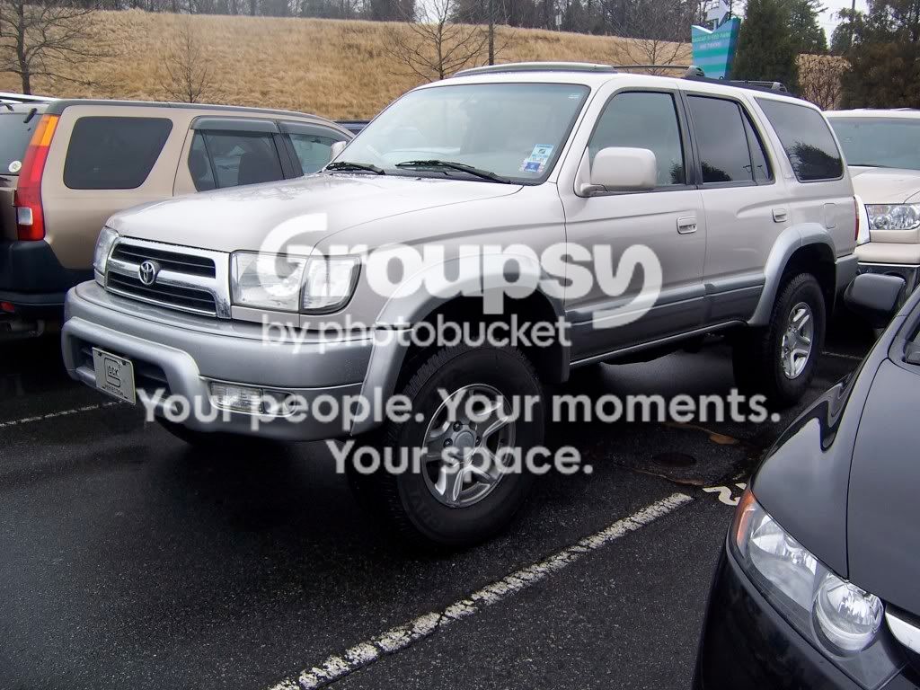

I just went with the 1 1/2" daystar spacer lift since I already have the taller coils

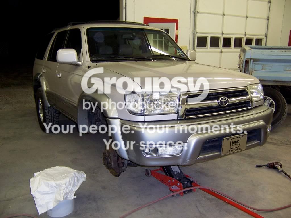

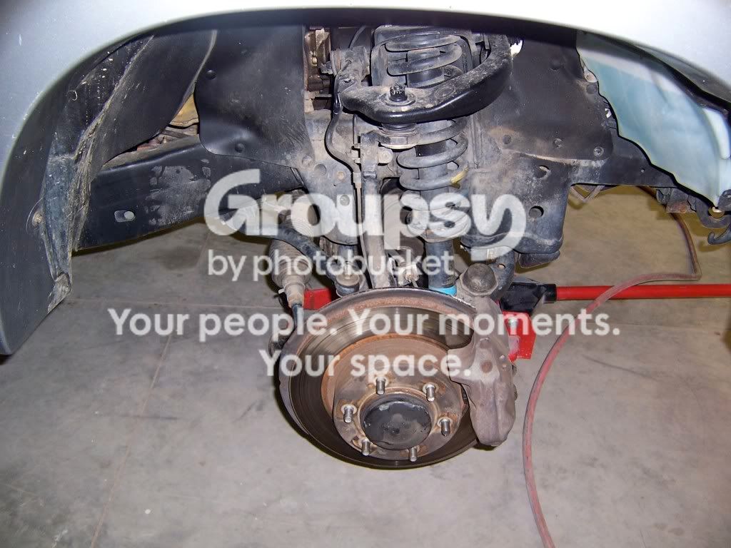

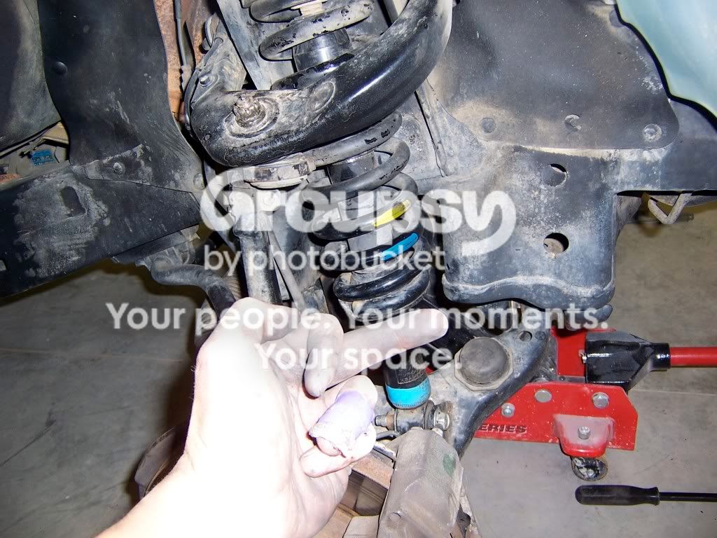

99' Limited 4x4 w/ 16" alloys... the coils had the blue/yellow... pink whatever stripes on them... the coilover was a ***** to get back in so I couldn't imagine putting the 2 1/2" spacer on top of these taller coils.
During the process of compressing the coils, I had some shty spring compressors and I had to use 4 vise-grips to keep them from sliding, when BAM they slid in a split second and crushed my left ring finger... so I did what any man in his right mind would do..... i taped it up with some purple maskin tape,, bwahahaha

Before
103_2985.jpg~original
After
103_2988.jpg~original
This is still with 265/75's ... Looking to get lx450's and put on some 285's :)
103_2990.jpg~original
103_2992.jpg~original
A lift always makes things look better, doesn't it!
I hope you're happy with the ride now, but something tells me you wont in a few months, but good luck.
Also, I highly recommend you invest in some jack stands for working on your ride, working under any vehicle thats just on a floor jack is asking for big time trouble. Seriously.
turned out looking good
that looks outstanding.
How is the ride? Can you tell a difference from the earlier setup?
