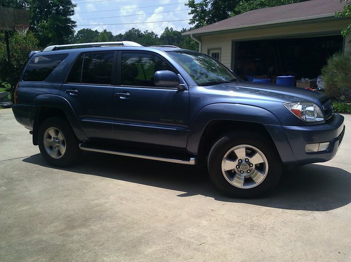

Wow, i never expected so much help :D
thanks everyone for your input, but it seems now that i have a lot more work ahead of me than i thought :D
thank you K.C. for all the informative threads.
ill be sure to post pictures of my progress as i mod up :D
heres what she looks like as of now :D
