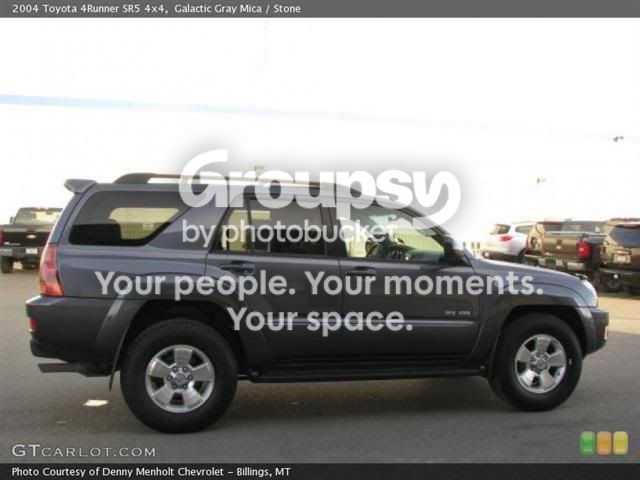

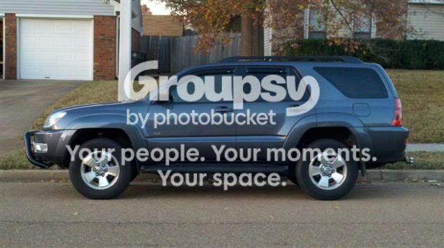

I really like it. I'm going to go up to a 265/70 when I change them out, just haven't got the cash for that yet. I'm probably going to lose 1-2MPG, but I can live with that. My brother has about 4.5" on his and I need to get a pic of them together, just haven't yet. Believe it or not, just leveling it makes a big difference in the look and it's cheap. It cost me $60 + the alignment. Just so you can see it side by side, here's some pics before and after.
Stock:
before.jpg~original
Level:
After.jpg~original
