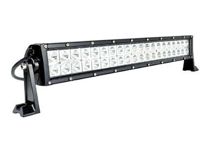

But my point is this:
If a pair of Rigid D2's
Can give a equal or greater light output compared to this
Then it may be worth the extra money to have a more compact, higher quality set up.
