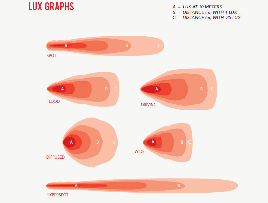

I'm planning on putting a set of ditch lights on my TE. I'm going to use them more for throwing light forward than to the ditches. I'm torn between the Rigid D2 spots and hyper spots. Can any one give me an idea of the beam difference? Google has not been helpful in finding a picture to compare them.
There is only the Rigid D2 Driving, Wide and Hyperspot. There is a Rigid Dually Spot tho. Here is the lux chart. For any forward facing light above the roof line, we highly recommend the tightest beam pattern you can find like the HYPERSPOT to minimize hood reflection.
Here is a lux chart showing the different beam patterns of the dually light series. Let us know if we can answer any questions!

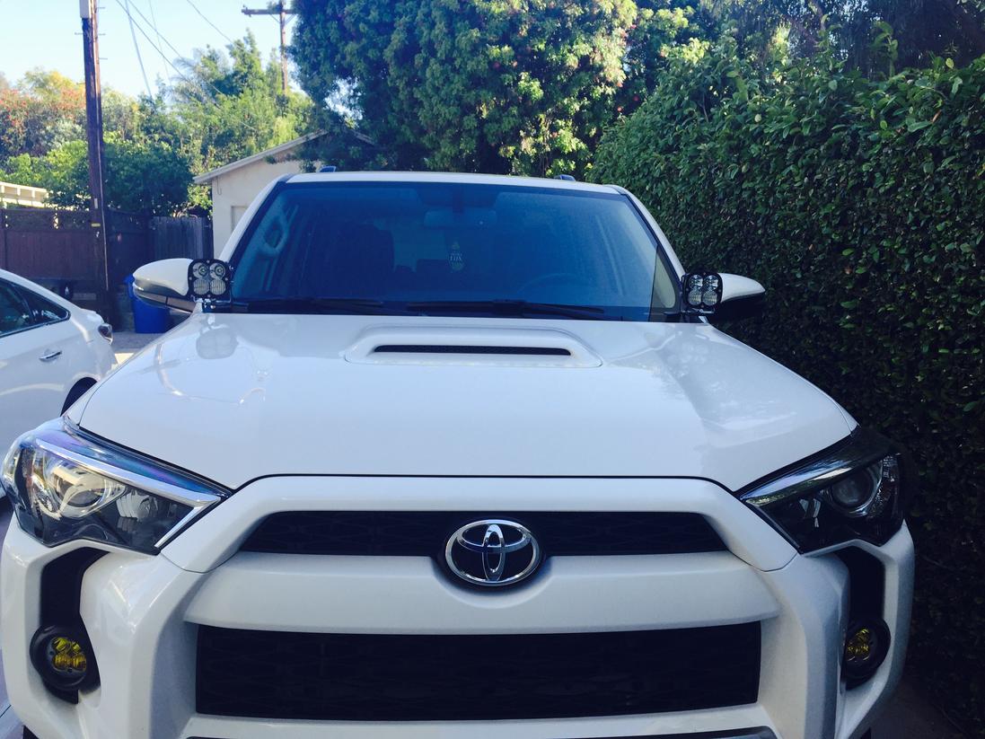

This is my setup with Super Duty Headquarters ditch light brackets and Baja Designs XL lights.
