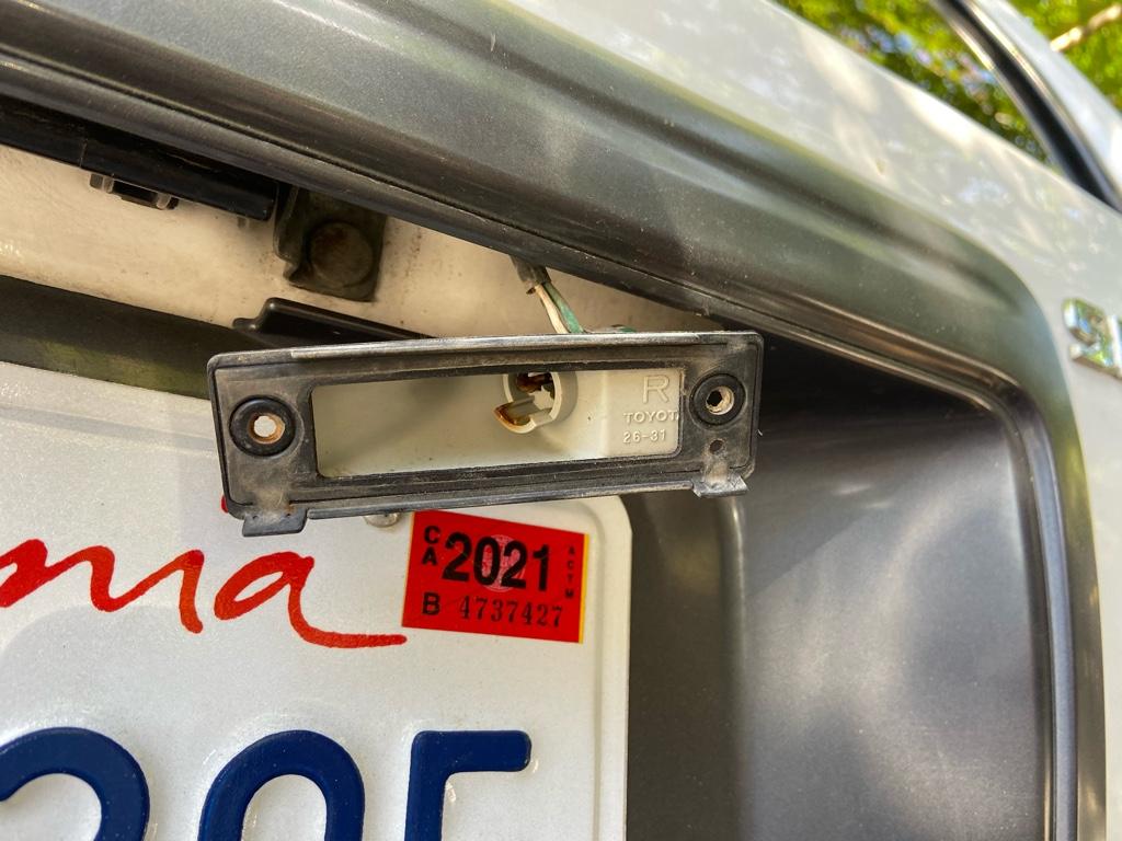

My dad and I were out on a trail the other day while it was raining, and while he drove my 4Runner I noticed that my center brake light and passenger license plate light are both out. I wondered if anyone knows the part number for the license plate bulb...

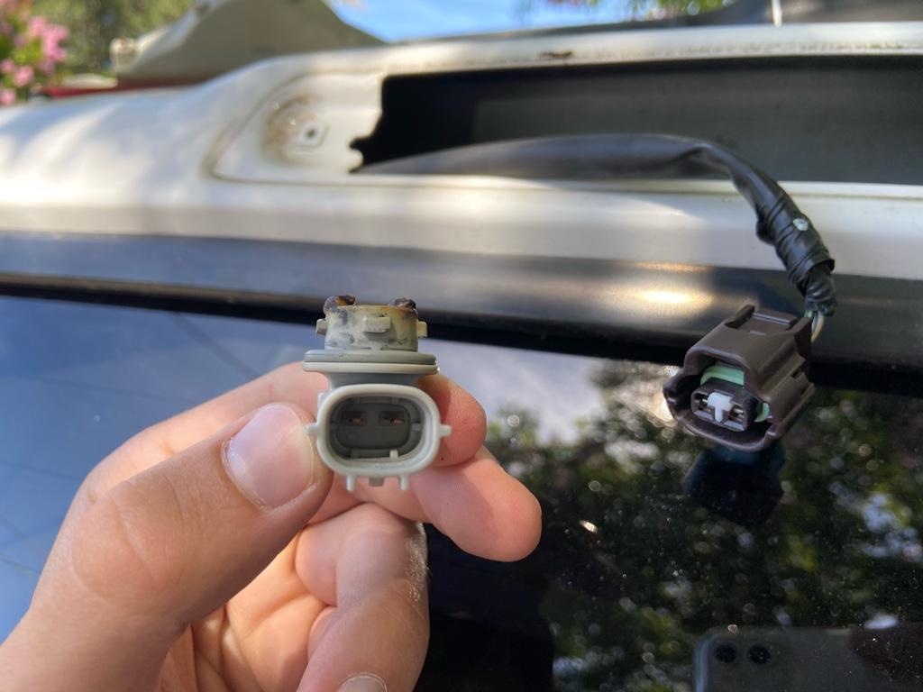

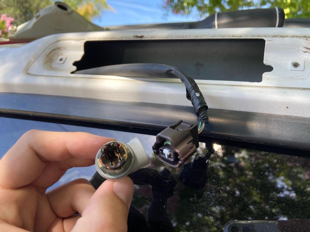

The center brake light bulb and socket were charred and melted. I'm wondering if anyone knows of a good LED replacement bulb and/or a part number for the socket that is pictured below.

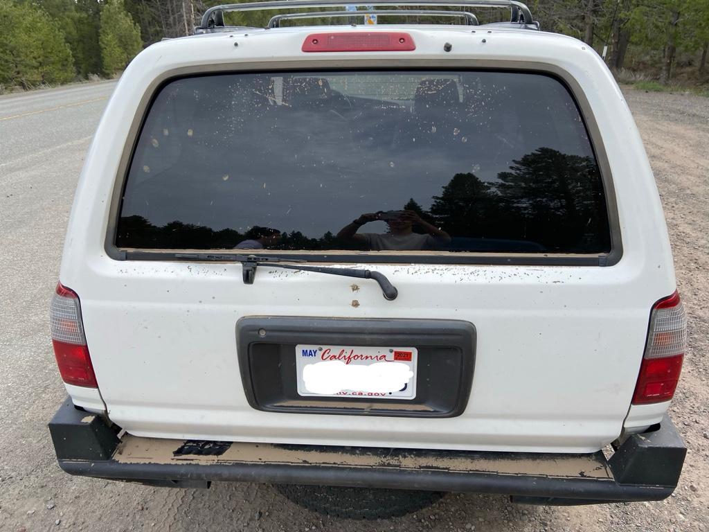

Lastly, does anyone know which CBI bumper this is?

2825 - Amazon.com: SYLVANIA - 2825 Long Life Miniature - Bulb, Ideal for Interior Lighting - Map, Dome and License Plate (Contains 2 Bulbs): Automotive

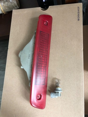

That looks to be a KOITO E4-2. I don't see it available alone, looks like you may have to buy the whole center light assembly - 81570-35040 High Mount Lamp - Toyota (81570-35040) | Toyota Parts
Some discussion here - broken 3rd brake light ?

Thanks for those links, ordered the license plate lights.

Looks like a good light, I'll probably end up getting that one. I also need the socket that the light plugs into, as it's melted. Toyota said they will only sell the entire assembly, does anyone know of somewhere to get just that gray socket?
The bumper is the CBI hybrid since it has the tube welded in closest to the fill panel for the lift gate. Their plate bumper has sheet metal on that portion.
3rd Gen Toyota 4Runner Rear Hybrid Bumper | 1995.5-2002 - CBI Offroad Fab
Thanks, I did some research and realized that last night. I'm really disappointed that the PO cut off the tow hitch portion. It adds a tiny bit of extra clearance but would've been really nice to be able to tow...:mmph:

Every single 3rd Gen I've owned (that makes 6 now) has had a burnt 3rd light socket. Some worse than others. If you try the junkyard route, go to one with several 4Runners becasue it will probably be in the same condition.

That's a nice list, but the license plate bulbs are not 194, they are W5W, or 2825 (or 168). They are physically interchangeable, but 168 is about twice as bright as the 194.

Well that actually sucks...... are there any aftermarket options for that connector piece?
Go to a pick n pull and grab the least charred one you can find. They'll probably even give it to you free since it's not worth the transaction fee that they'll have to pay. Worked great for me...
I just went to a pick n pull nearby and got 2 connectors in great shape :)
