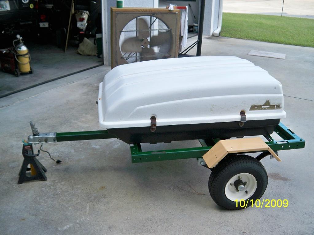

I have a year + build going on with this trailer. I know, small tires. But the thing is light so I can drag it over stuff.
If I find a great deal on some taller 4 lug tires / rims, I'll upgrade then.

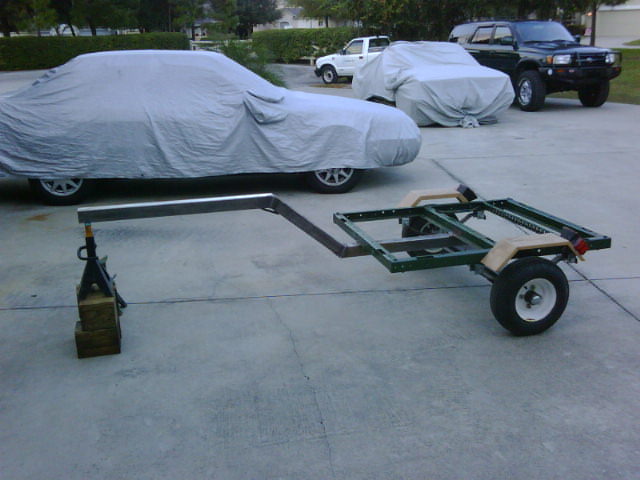

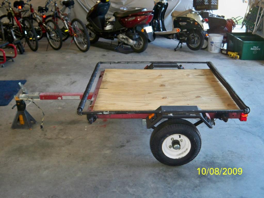

This is what I started with over a year ago...

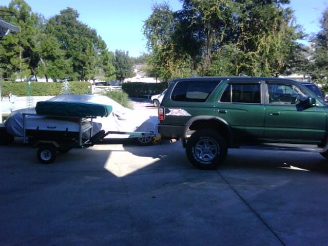

This is what it ended up being at the time, since I had no roof top tent to put on it. Being a cheap build and all, that was all I did. The Wife got sick at the begining of the year, so no attention to the trailer build. Just sat in the back yard.

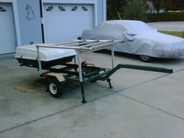

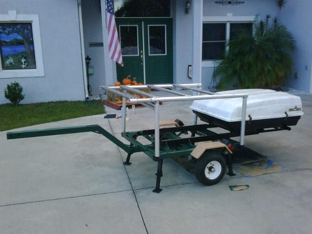

Raised & extended the tongue.

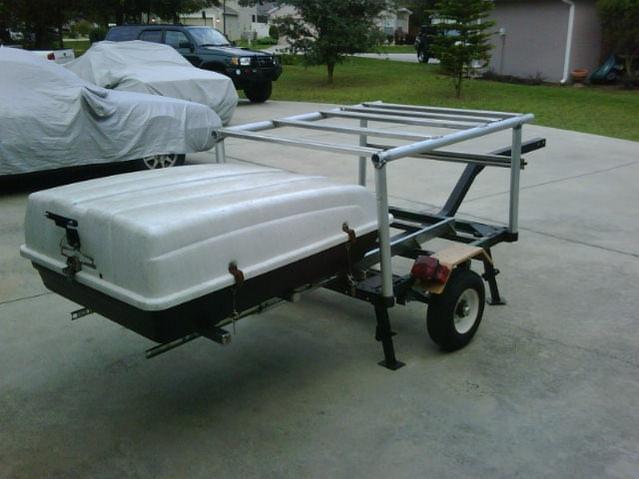

Mounted some legs to stabalize it when stationary. Mounted the cargo carrier on a set of long drawer slides to get out from under the RTT when opening.

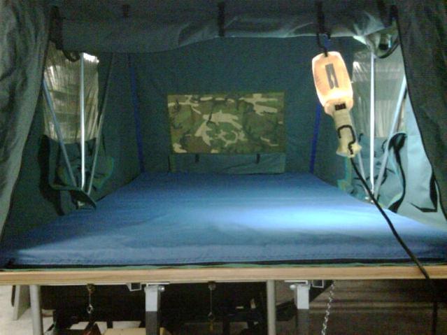

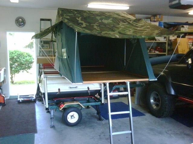

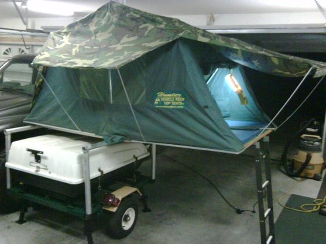

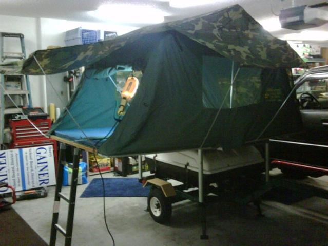

Bolted the tent to the trailer Wed. night & took some pics.
Still some tweaking to do, but coming along nicely...

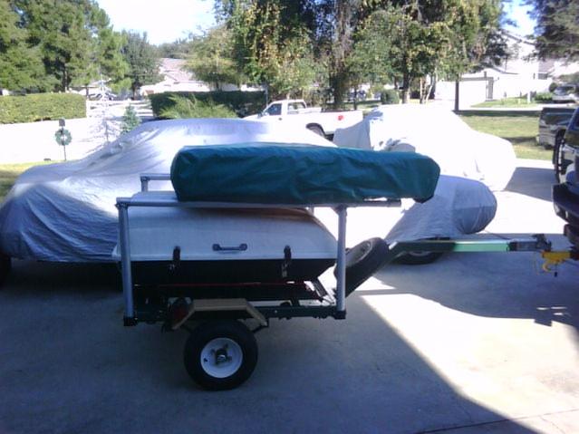

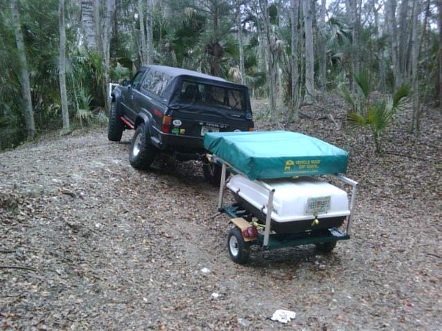

Got the trailer lighting issue straightened out on the 4Runner, re-wired the lights on the trailer. She is now road worthy, and even has a spare tire.
Went for the first run over the weekend.... to the transfer station to get it weighed.
380 lb. empty. No bad. :)
Here are some more pics... not camping pictures yet... they will be taken this weekend. :cheers:

Talk to Jacque or Barb. I have been very impressed by the quality of my Mombasa tent. There are a few cheaper tents out there, but it is kinda hit and miss whether you get a high quality one or just a cheap one. Looks like topdown got lucky. I know a few folks who didn't and ended up having to buy a new tent after a few trips.
As far as mounting the tent, I used some cold rolled bar stock to attach to the rack on my truck bed trailer. Almost all rooftop tents (All Mombasa tents I know for a fact) have sliding attachment points mounted to rails on the bottom of the tent. All you need is something for them to mount to. Notice how topdown mounted his on those support bars.

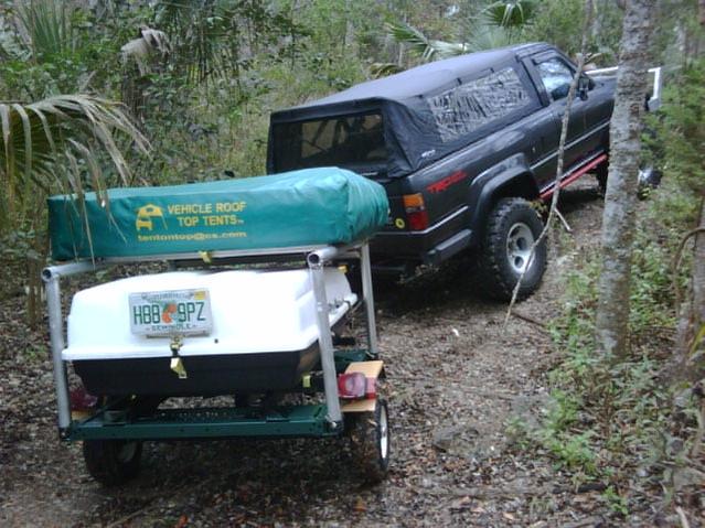

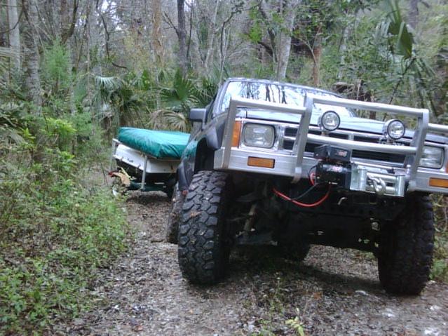

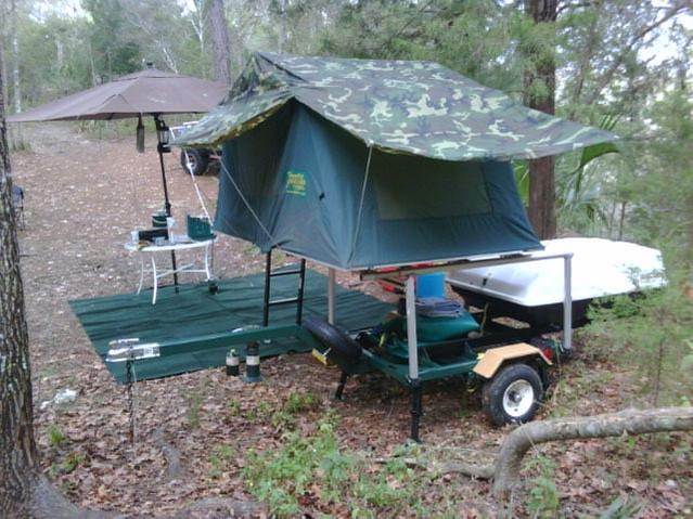

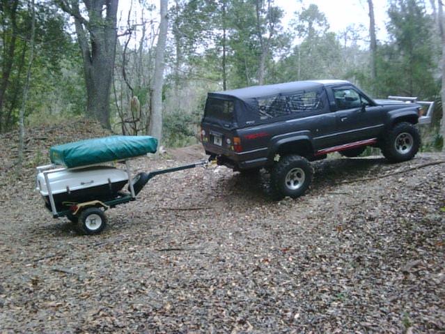

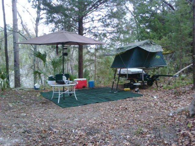

Took the new camper out this weekend. Had a blast ( damn it was cold! )
The 4Runner acted like the camper was not even there. Mission accomplished. :)
