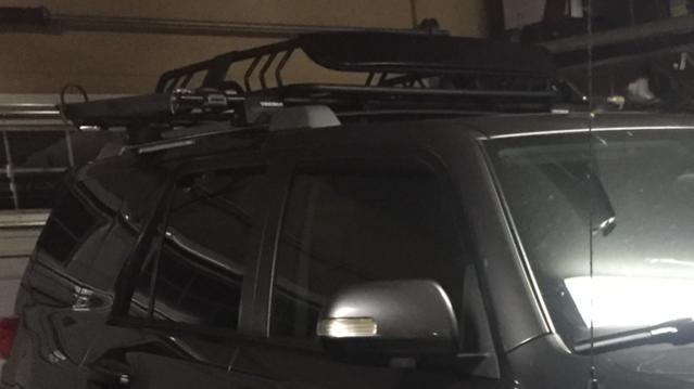

I think it depends on where you mount it, you might want to try it out. I have mine mounted to the rear bar in the front of my Baja rack and the glare is barely noticeable because the deflector blocks the light that would be hitting the hood. Having it mounted up high seems to make a big difference for how far it throws and allows you to see much further when cresting small hills.

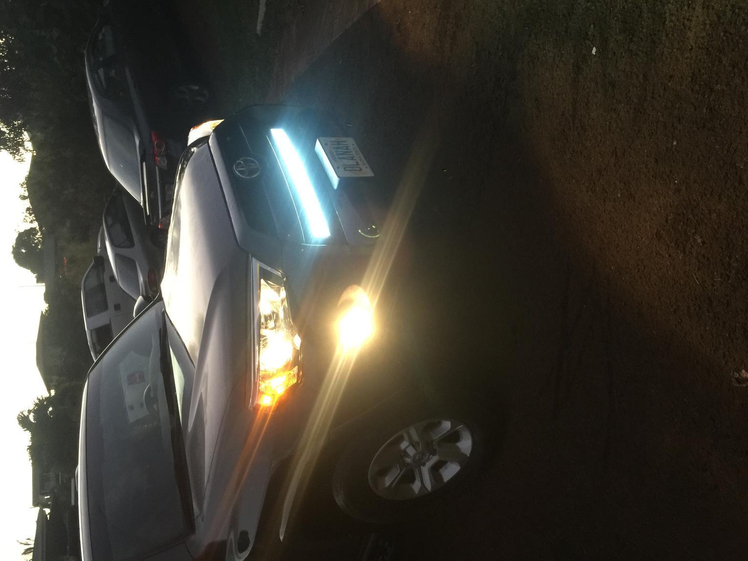

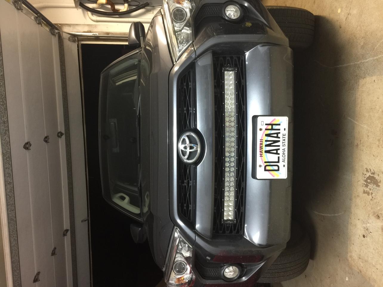

For my ride I wanted the stealth look, decided on a quality 20” Baja Designs Stealth LED light bar ($500, well worth the money IMHO). Installations wasn’t bad (sorry no write-up), removed lower plastic grille insert (bumper cover does not need to be removed), added two ½” spacers under mounting brackets to raise light high enough to allow for adjustment. Center light bar in opening, mark mounting holes, drill and tap aluminum bumper, mount light, install wiring harness http://www.toyota-4runner.org/5th-gen-t4rs/159174-factory-style-fog-light-switch-fits-knock-out.html
, turn on and aim light bar for proper adjustment. Cut plastic grille to fit around light (leave a little extra room so future adjustments can be made (up/down), reassemble, enjoy your new light bar!

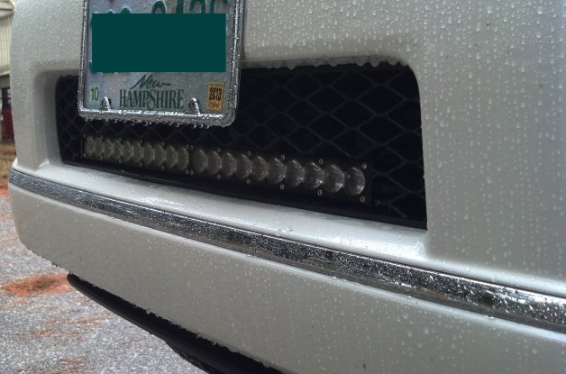

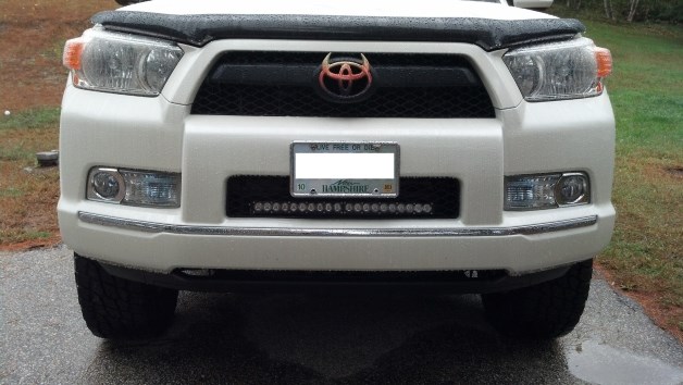

Recommend you take a look at The Retrofit Source. Quality product, very bright and minimalistic in size. If you want that low profile, modern look, they are the right light.

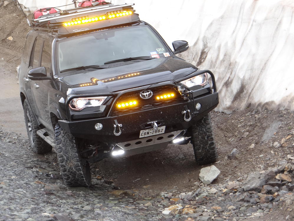

Front lights: I love my 40" bar uptop, I got a chance to really use it over the holidays during a long drive home (over night so traffic was minimal in the UP) and the bar was on for hours, it made driving much more enjoyable with the extra light/depth and width. I have now installed 4 spot lights up front and they do a great job at extra deep throw but if I had to chose one or the other it would be the 40" mounted high over the spots mounted infront of grill.
