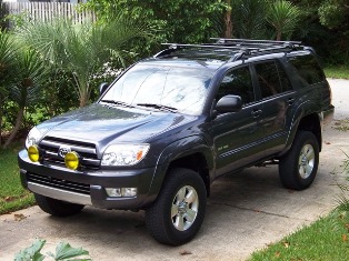

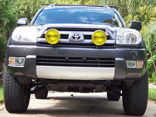

Sorry - I did this back in early 04 when she was new. It was hard to drill into the bumper of a 30+K new car!
Very simple - just picked the location of the lights and drill the hole. I did use a flat section of stock as a backing plate - you could use a large flat washer as well. I used a bigger flat washer between the light mounting and the plastic bumper.
Hardest part is drilling into you new car.
I'm thinking of adding a 3rd in the center.

Colemanfu- do those rattle around much when you are offroading? Also how do you like the LF 170's? Those are the lights I really wanted- but the deal on the KC's was just too good to pass up (although I can always time to upgrade....)
I am getting my lightbar any day now (hopefully) I am just waiting to get it powdercoated. I thought about mounting them directly to the bumper like you, but I couldn't bring myself to drilling holes in the bumper. Plus running 4 lights on the bumper would look totally ridiculous, or maybe be just impossible
