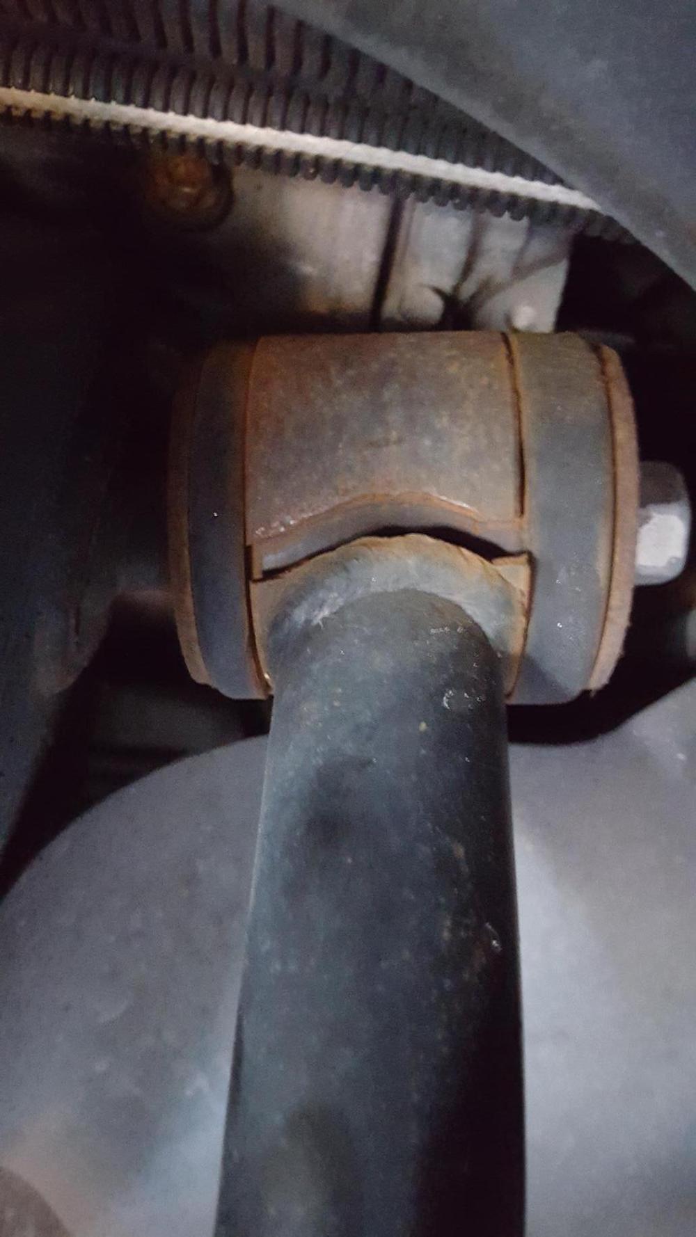

Light Racing UCA failure! Found this today when I was rotating my tires. LR says you need your original receipt to show proof you are the owner, I bought these back in 2012 and did not keep a copy of the receipt....warning to others, make a copy!!! uCa.jpg

Give a shout to whoever you bought them from. I BET they can provide a receipt for your order.
UPDATE: I found my receipt.....thank you google! I've submitted this to LR and will keep you posted on the progress!

You might not see that crack until it's too late unfortunately,
looks like poor quality control, or design flaw.
base metal crack along the heat affected zone.
That's my thoughts on that failure as well, I saw that same failure on a member's 4Runner up close when we were off-roading. Oddly enough I believe he bought his in '12 as well. Supposedly their quality control is better in the last year or so compared to before...

I'd actually call that a catastrophic failure, while in this particular case it only split open a couple millimeters apart before the owner noticed. I've seen that same head affected zone failure while off-roading; the result was that the bushing loop opened up enough to fall off the strut tower and almost bend the crap out of the other loop (surprised it didn't break off to be honest.) Needless to say that 4Runner was going home on a flatbed... after some creative use of ratcheting straps to get the spindle straight enough to roll it on the flatbed in the first place.
All in all the owner was lucky that all they had was a broken ABS wire and UCA; the UCA had almost completely broken off allowing the spindle to move quite a bit and could have torn the boot, brake line, bent the tie-rod, ect. It's just a simple crack, but it can compound pretty fast given the right circumstances or a good pothole.
Yeah, I don't know why he's downplaying such a major flaw in a suspension component. Imagine if this had not been caught in time and the owner hit a pothole on the freeway.
