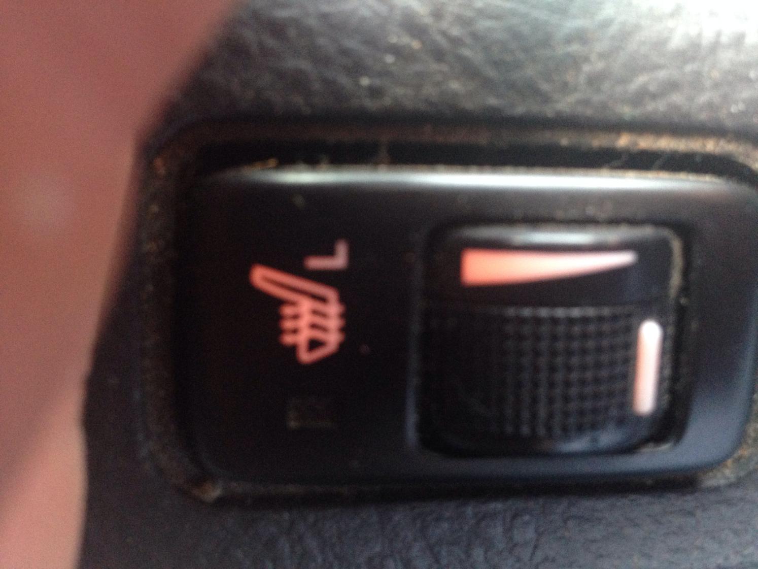

Mine from the factory light up and they are a dial switch. The picture is close to show that they are lit up

Thanks mac. Since mine is aftermarket I also need to find switches that have 3 terminals. Not sure if the factory switches like you show are 3 terminals or not. I found some pretty nice ones but they're 7 terminals (lol?). Not sure why it needs 7, but that's what the site says.

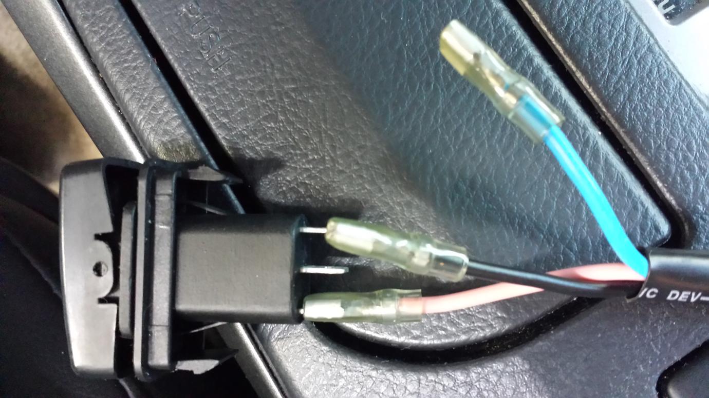

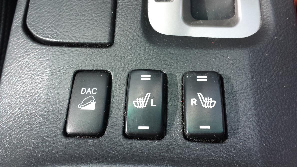

I'm considering getting this kit off eBay. The switches are 39.9 x22.9 and illuminate. The seller says it's the manufacturer and they sell from CA. Perhaps you could PM them and see if the can sell only the switches.

No. I'm considering the whole kit. I don't have heaters yet. I just suggested that OP try to PM them if he just wants the switches. The measurements on these look like they will fit the factory spot on the 4Runner.

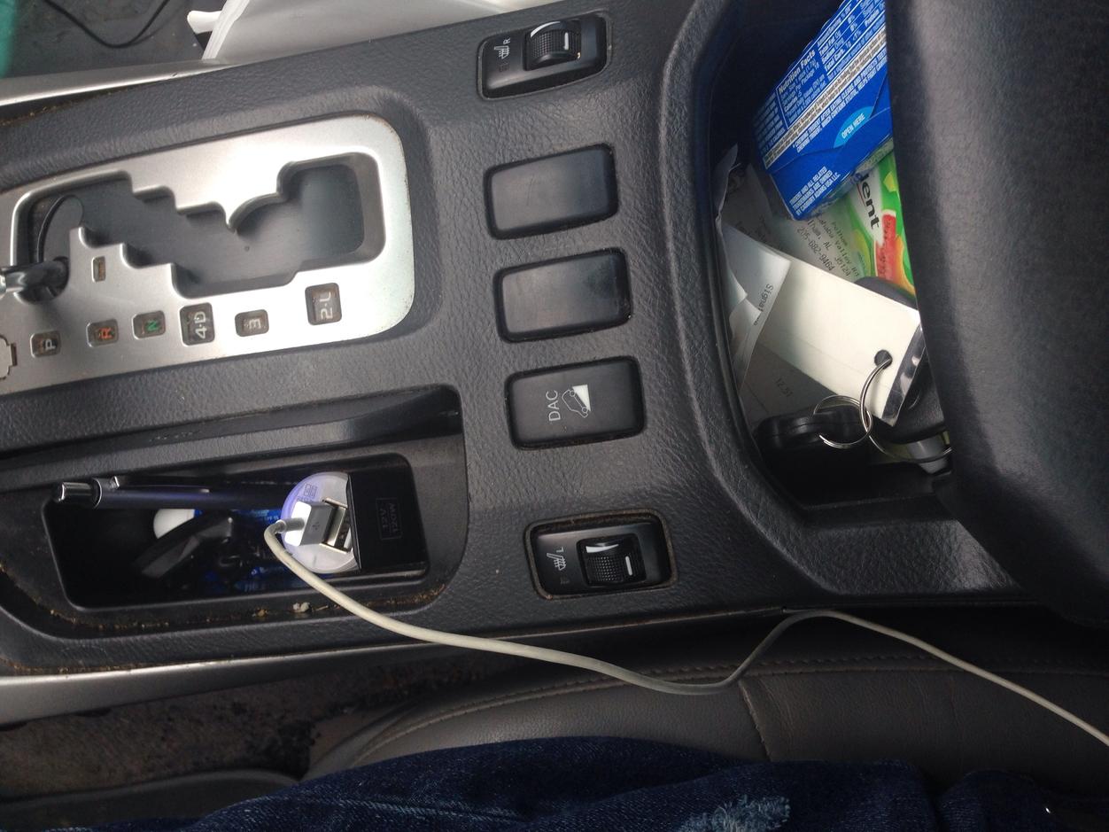

Finally took some photos of the switches for the seat heaters. Anyone have any spares or know where I might get some? Only need the Left (drivers) one, but I'll replace them both to keep them matched.

You might try here and yotatech for someone who is stripping a 4th gen or put a wanted ad in the classifieds. Those switches don't seem to light up. I might look under the console to see if the '08 is prewired for seat heaters. It's hard to consider it important while it's still summer.
