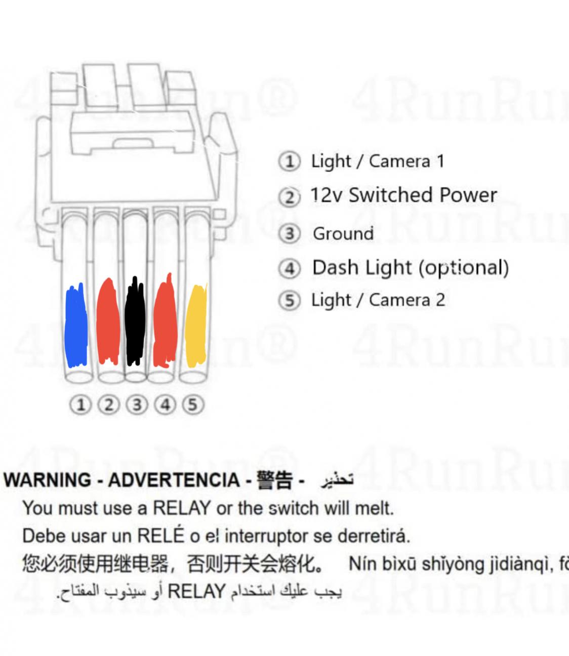

It is a little embarrassing how lazy these Chinese electronics companies have become. You are basically getting sold half of the product you would need to power your light accessories. This "dual LED light switch" is really a dual relay activator. If you tried to use this alone to power the 4 Pods at 12V 7A, the switch would burn up.
They know they are preying on unsuspecting customers. Their lack of instructions and putting "You MUST use a relay" is a way of saving face. These switches are used to trigger a backlight on the buttons when the vehicle is on, to trigger a positive current to activate relay 1 (you have to buy separately), and to trigger a positive current to activate relay 2 (also sold separately).
Rant aside, relays such as this is what you will need to buy to run this in your setup. Amazon.com: 5 Pack 40/30 AMP 12 V DC Waterproof Relay and Harness - Heavy Duty 12 AWG Tinned Copper Wires, 5-PIN SPDT Bosch Style Automotive Relay: Industrial & Scientific
You need 1 if you want to run the entire circuit on 1/2 of the buttons on that switch. You will need 2 if you want to use both buttons.

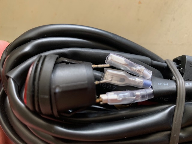

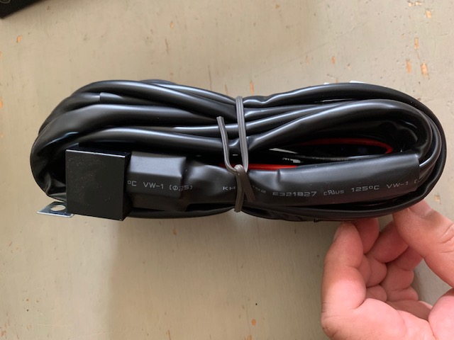

The squadron comes with cables that has relay built in already (attached picture 1)

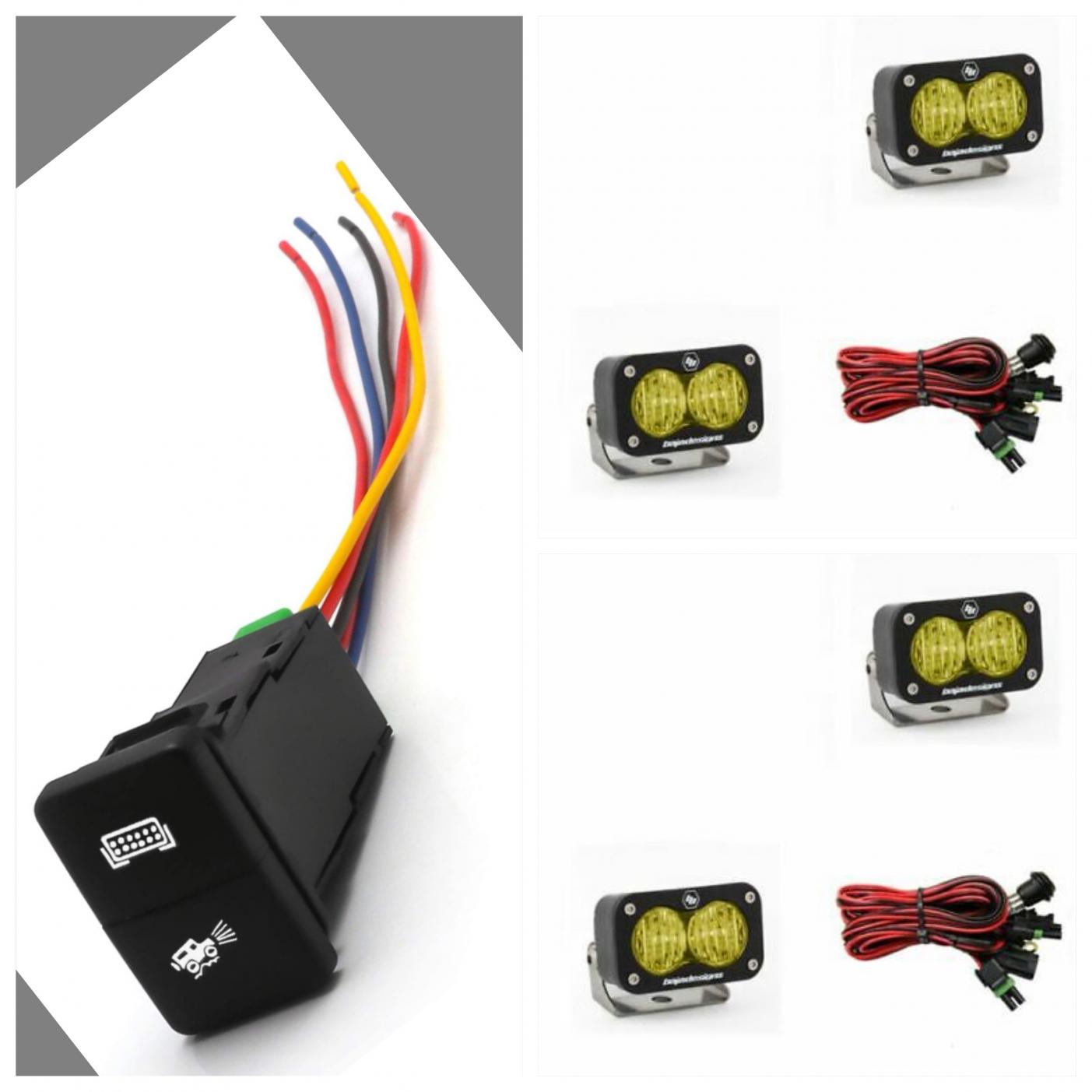

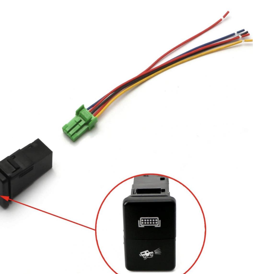

And here’s the switch with the 3 wires that came with it.

On the switch that came with your Bajas, each wire should have a symbol where its connected. Generally, switches top to bottom go
1:Red "HOT"
2:White "Relay"
3:Black "Ground".
Not sure how yours came wired, but the above is just a guess based on other wiring toggles I've seen come with wiring kits.
If you're doing two sets, you'd want to do a second wiring kit and relay, and then do the same wiring pattern to the dual switch you would be using. The relay cable is what would differentiate the two.
Looks like Tundra guys have it figured out for a factory switch.
Help with wiring for Baja DesignSquadron to factory switch. | Toyota Tundra Forum
