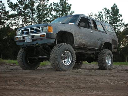

Well I bought this runner about 3 months ago now and the overall condition of the runner is great. Well at least I thought it was. I havent done much to change it yet but as you all know it will always be a work in progress.
I did change one major thing pretty quickly...when I got it, it was *cough* Brabie Pink *cough* it is now primer awaiting a new look. Im not sure what color I will do next.
Problems:
I am using about a bottle of brake fluid a week because my Load Proportioning Valve is leaking really bad. Hopefully soon Ican get a Manually operated one installed.
I decided to rip out all of the carpet sinice I got it wet 4wheeling. After getting it all out i noticed that the driver side floor had Cancer...it didnt look bad at first. Now that I have had time to get in there and check it out more it is pretty bad. About 3 spots all the way though the metel.
My rear window will rolld down if you use the key but not from the switch in the cab, the switch will roll it up though.
Thats all for now....check back for more updates and pics.

The floor rust may be due to a leak under the dash, a fairly common problem.
The rear window issue is also common, try raising it via the key but stop it before it shuts all the way, then see if it works up and down with the inside switch (again not closing the last 1/4").
That's what I've been doing the last year or so until I have time to fix it. :D
