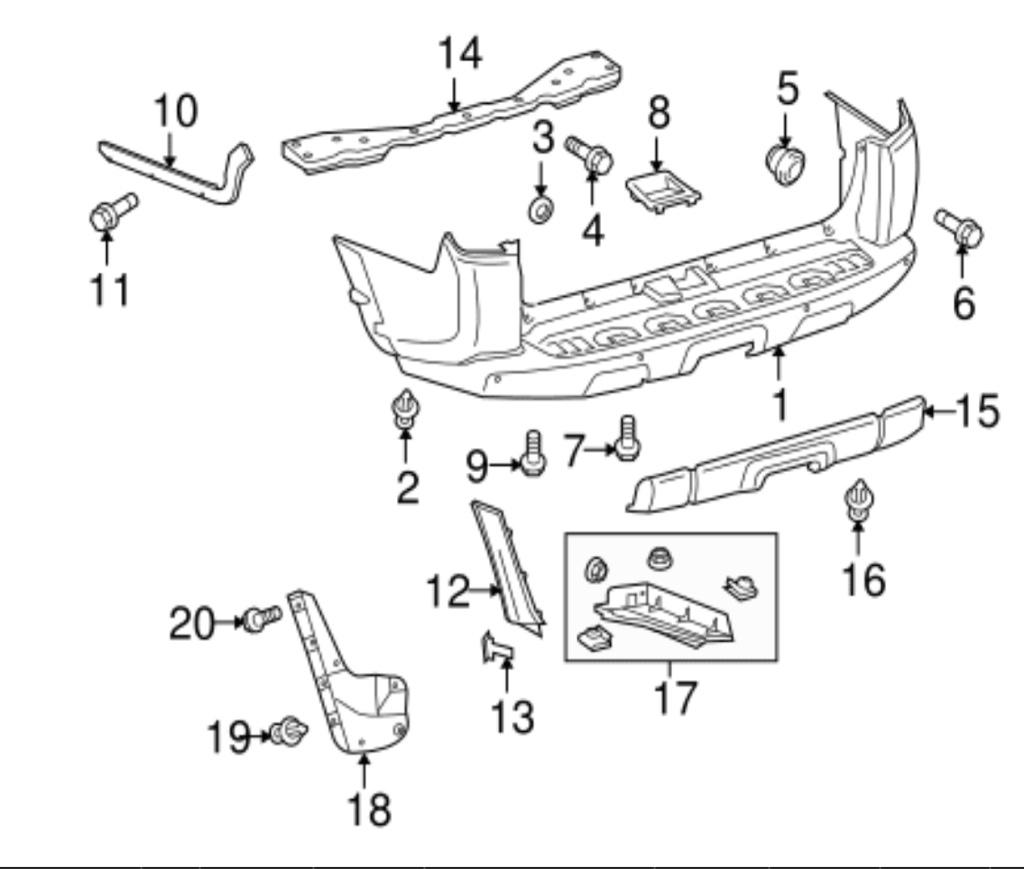

Next week I'll be replacing my Limited rear bumper with an SR5 bumper I bought. Will the Limited rear fender liners work on the SR5 bumper cover..?
After paint and sensor relocation it'd be a bummer to find out I need new liners...
I did the same swap. I didn’t change the liners, only the mud flaps and item #17 qyt 2. Also I had to remove some bracket near the tow hitch.

I wonder if that #17 is relevant to the TRD bumper cover you installed....hmmmmm. I'll have to look up that number and see what it is and if I need it. I'm not doing mud guards..but that #17 has me puzzled.

** Edited ** # 17 in your list are the bumper cover brackets..left and right rear is what I ordered. Where do those install..? Or is it obvious during assembly..?
Yes those are them. Your limited bumper has them too but they won’t fit the Sr5/trd bumper. They help stabilize the sides of the bumper when installed.
