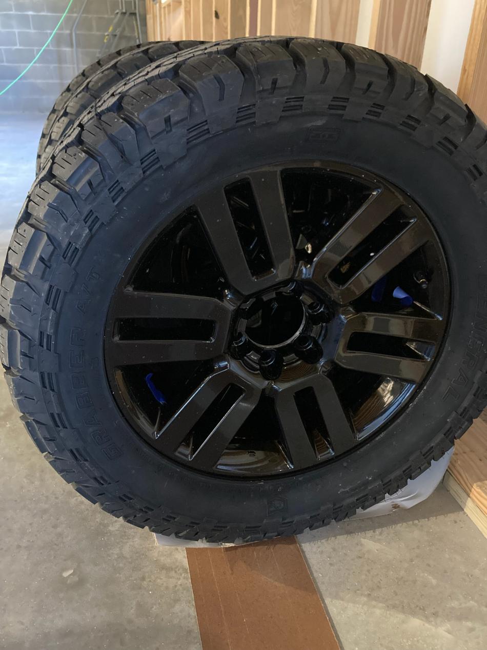

We ended up going with 275/55/20 Nitto Recon Grapplers on ours. The tire selection for anything that fits the factory wheels correctly is not great. For several months we ran the 275’s on the factory wheels but I was not a fan of the sidewalls being squished in to fit on those narrow 7” wheels. For Christmas we upgraded to 20x9’s and this thing looks SO much better.

Yeah, I have seen the countless debates regarding 275s, count me as conservative Re the narrow rims. Just thinking the 255 might be a nice mellow and safe step.
Understood. I seriously debated staying with 245’s as my wife drives this thing but couldn’t bring myself to stay with the skinny oem tire size. On the flip side, I wasn’t real keen on having the wider 275’s on the oem wheels either.

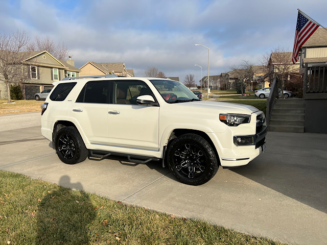

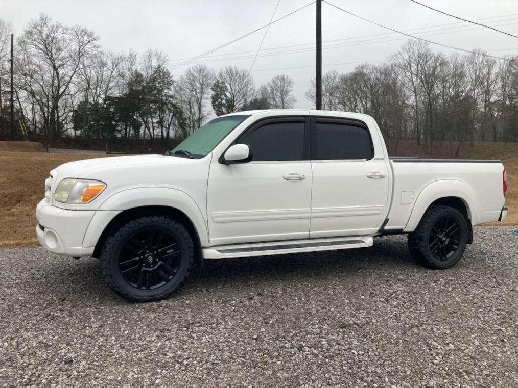

I have a few different sets of Limited 20s and have tried lots of different tires.
I have owned like 6 sets of the Limited 20s and probably put 300,000+ miles on them across a few vehicles.
I have owned
285-55-20 BFG AT
275-55-20 General AT/X
305-50-20 General AT/X
I owned 2 sets of the BFG AT, wore one set out and sold the second set when i switched to the 305-50-20 Generals.
I have owned 4 sets of the 305-50-20 Generals
I have owned 1 set of the 275-55-20 Generals.
When running a wider tire on the narrow rim, you must MUST run lower air pressure to get the tire to widen out. I check the tires by driving on a white gravel road, and then on pavement and checking to see how much the white dust it wiped off the tire and change pressure to allow the full contact patch of the tire to touch the road and wipe the white dust off the tread.
I am usually around 22-24psi up front, and 18-20psi in the rear running the 305-50-20. Sure this sounds wild, sure this is below everyones typical operating pressure, but it works and it rides like a dream and the tires wear forever.
I have 26psi up front, and 20psi in the rear on the 275-55-20 Generals to get them to flatten out. I have never had a tire failure, bead failure, puncture, flat, or any tire related issue with the tires, wheels, or pressures i run.

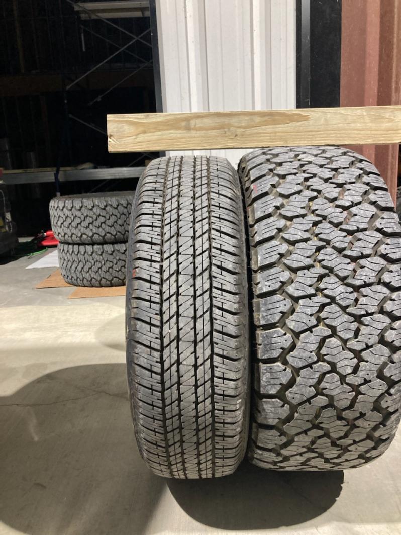

Use the tire size calculator and compare your known size out to whatever it is you want to run and see how close they compare. I have run the 305-50-20 on my tacoma, tundra, and two different 4runners. I switched to the 275-55-20 on the tundra because the 305-50-20 rubbed the upper A-arm too bad and was cutting the side of the tire. I have a set of the 305-50-20 on my current 5th gen 4R and absolutely love them. My 4th gen has a set of the 265-60-18 on the limited wheels and i have 96,000 miles on the General AT/X on it and still have tread left. I absolutely love these tires.
Tire Size Comparison
I'm debating throwing the 20s back on my 4runner, and was wondering if the tire availability situation had evolved. Those 245s are just to skinny.
I did some tire size comparisons and 255/60 is quite close but has just a bit more width and sidewall. Turns out it's a Land Rover OE size so there is some tire selection. Anyone tried it? Too bad the availability at 265/55 is so limited...

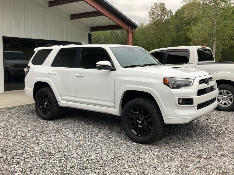

Always been a fan of the Duratrac and stumbled onto that size in this old thread. To have a size option that you didn't have to worry about the wear and narrow rim is interesting.
You have my attention with the half price or the 275/55!! I hadn't seen that in my searches. I'll have to do a deeper search?
Stock comes and goes on Amazon - but IIRC I paid $125/ea for mine delivered. I see they have some other sizes in stock right now, but this doesn't show up as available for me. (sometimes they exclude my zip code since I'm in Alaska right now). The coopers don't look particularly aggressive - and they're not. But they're closer to a typical AT than it might seem when you put them side by side. And they're totally fine for most fire roads to moderate trails. If you need Duratracs - they might be a little on the highway side for you. Just a low cost option that I thought worked pretty well. I really like the look of the Limited 20's. Really wish they sold them in a 8" wide rim.
