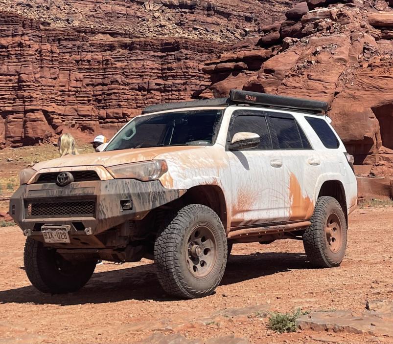

I switched over to 255/80/17 Wildpeaks last season and I will never look back. I ran two sets of 285/70/17s wildpeaks AT3ws and toyo ATIIs before switching, got 40-50k out of each set. I would say I prefer the 255 offroad for a little extra clearance, no real noticeable difference but it wheels as good if not better in most conditions. On-road the vehicle feels lighter and accelerates better but is still overall pretty stiff with the E-load.
One of my biggest complaints about 285s on a lighter truck like the 4runner is the way the front end would float and skid through slush & unplowed heavy snow. No such issue with the 255. I think its overall better in winter with a smaller contact patch / more pressure.
I know the stanced out IG builds look good on 315s w/ -38 but the 255 is super practical and taller than all the 285s. It has just a slight stickout from the wheel well on 17x8" wheels with 0 offset. Still kicks up a bit of mud onto the doors but not too bad.
