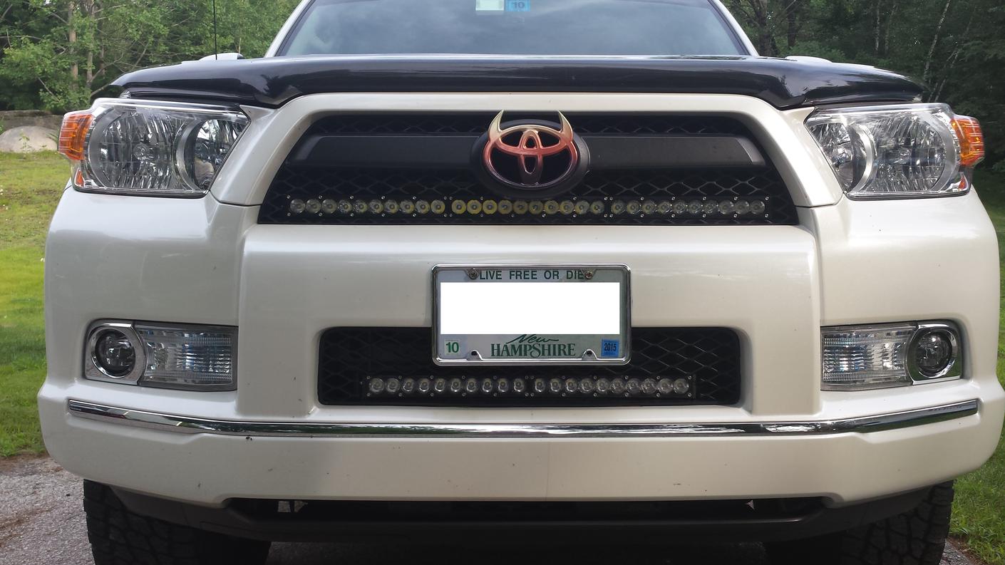

Can't you just do what these guys did, with different length brackets since the grill opening is in a different spot?
http://www.toyota-4runner.org/5th-gen-t4rs/164966-led-light-bar-install-2014-toyota-4runner.html
http://www.toyota-4runner.org/5th-gen-t4rs/117592-20-light-bar-stock-grille.html
Thats the problem, I have some mechanical knowledge, but zero in custom fab. I took off the front bumper and The location of mounting base to where the bar would actually have to be positioned is pretty far, so lots of fabrication work would have to go into this, unless a different mounting location is used.
Looking at the front bumper, only the top part of the grill is practical for a LED bar, the bottom area is too confined. Someone even recommended switching out to a trail bumper, but for some reason I really like the Limited front end.

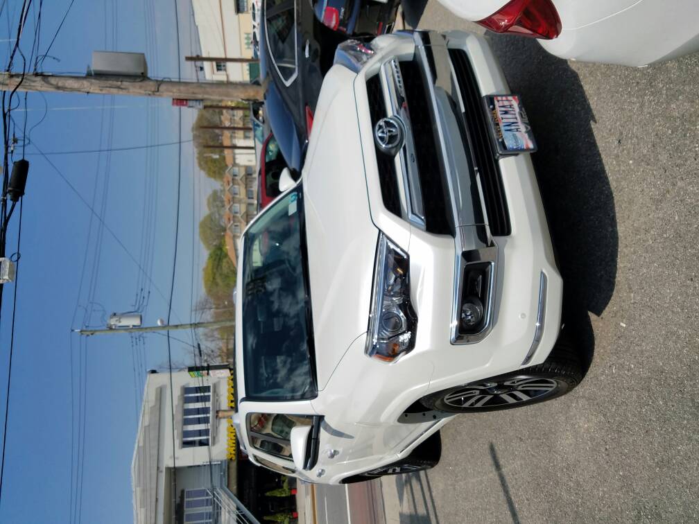

This is the best picture I have of the front end right now, but just above the large chrome piece is where I would mount. Preferably without removing the mesh grill (lots of thieves out here)
Don't know why it posted sideways.....

Talk to this guy, looks like he did a bar in the bottom area, may be your best bet for an "easy" install. Tall brackets could still work for upper grillbut you would need an extra stabilizer bar connected to something behind it, make friends with someone that can weld!
http://www.toyota-4runner.org/5th-gen-t4rs/186164-bpwwers-2015-limited-build-drive-thread-4.html

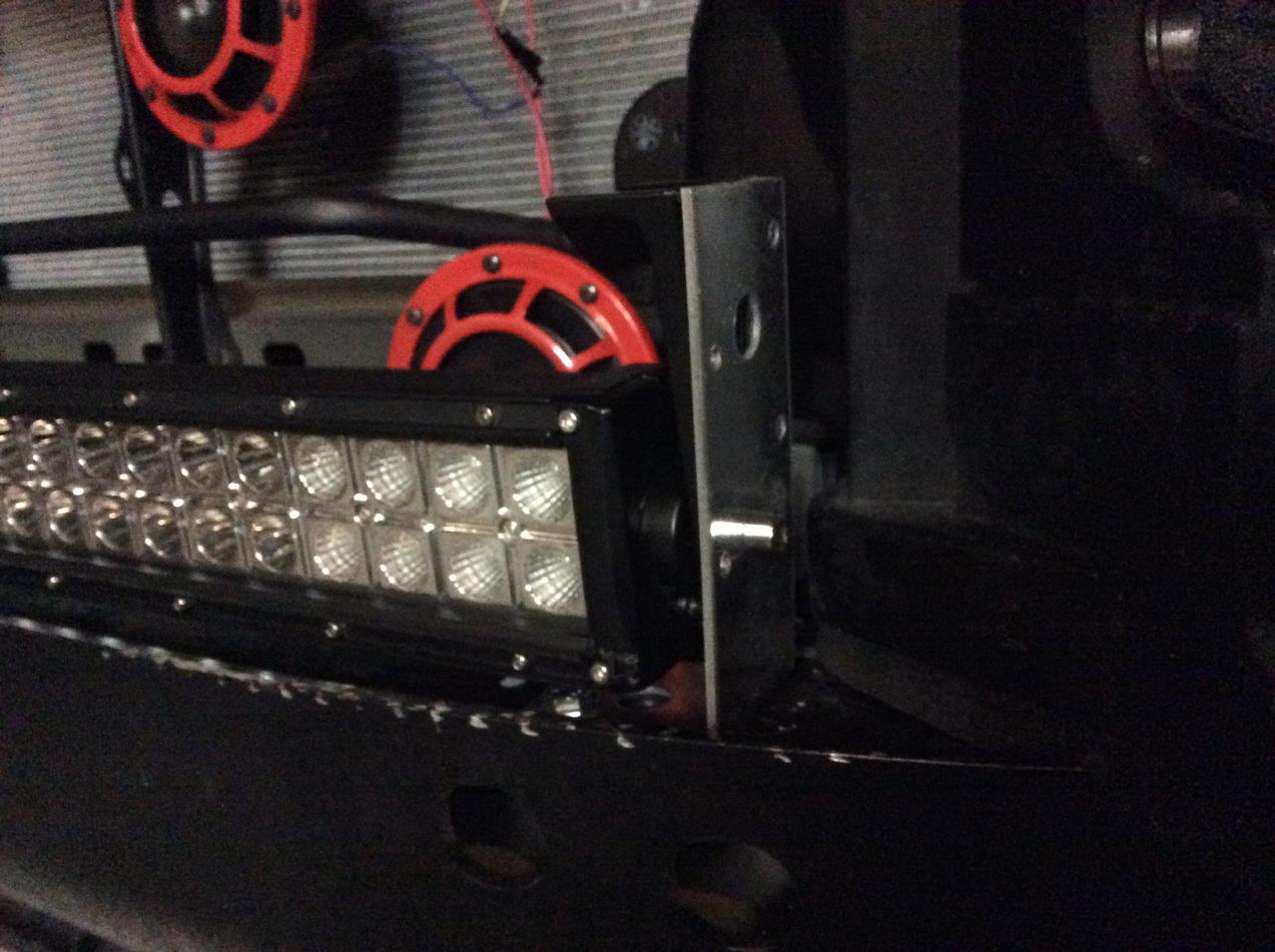

This was how I mounted my 32" light bar on 2016 Limited
I just used some L concrete bracket from lowe's.
The item is 17958 usp 2-in x 5-3/16-in cncr $3.15 x2 that's what's on the receipt.
I just drilled into the aluminum bumper near a existing hole an used a nut and washer to secure it.
If I wanted to add another light bar to the middle grill area, I would add extension to the bracket and secure it.

Any detailed pics of install and the brackets you used? Also, possible pictures of how it looks at that location with the bumper on?

I posted more info on Sakers thread "LED light bar install on a 2014 t4r"

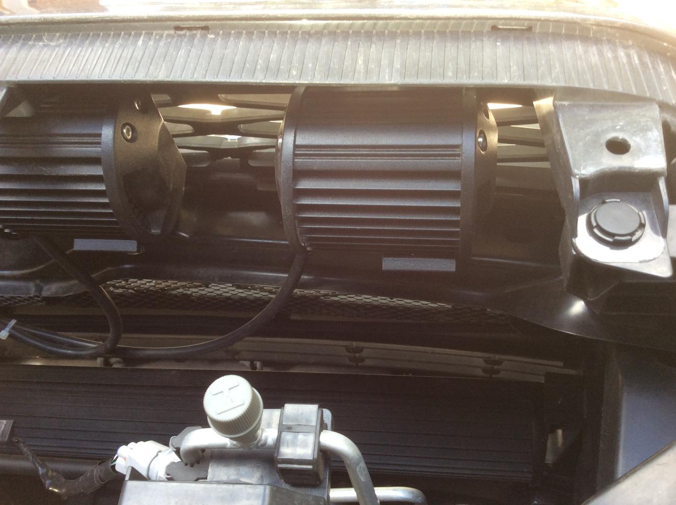

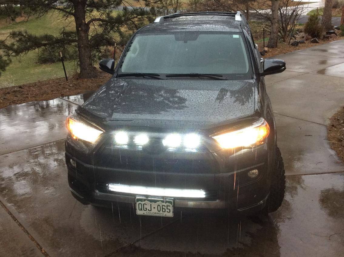

This is the 4 lights that I installed in the upper grill. I just mounted them upside down in the existing upper grill support bracket. It's the one the hood latch uses for renforcement
These look exactly like the opt7 lights that I used for reverse lights. Can't really tell if the add that much of a difference since the 32" light bar is is really bright.
I hooked them all up to the high beam with a override switch.
Hope this helps

It is pretty bright and functional. I am sure if it was not behind the grill it would be even brighter. I may add another light bar in the middle grill just because I want to try.

Here is a picture of the 4 lights mounted to the support bracket

That's the middle grill opening?
And what did you mount them to? You say support, but bare with me, where exactly and how exactly did you mount them?
That's the top part of the grill. The limited has 3 openings. Those are located on the very top. The mounting locations are toward the front. It's the four push pins that hold that top of the bumper on
