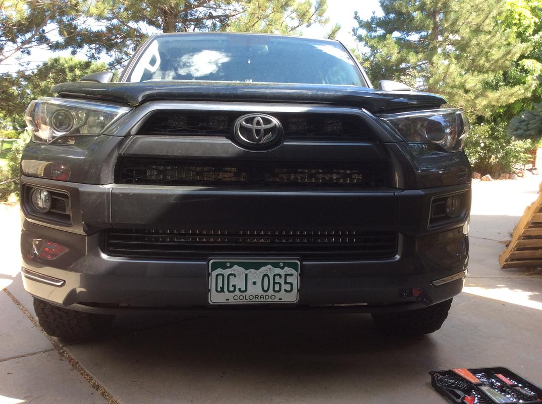

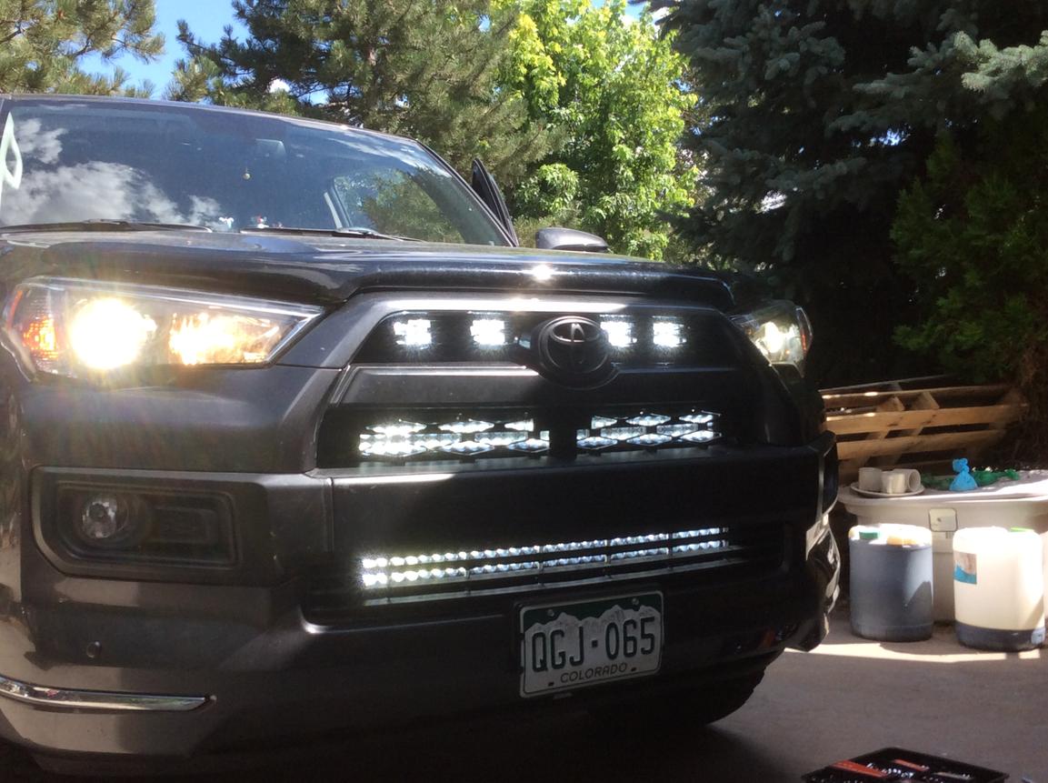

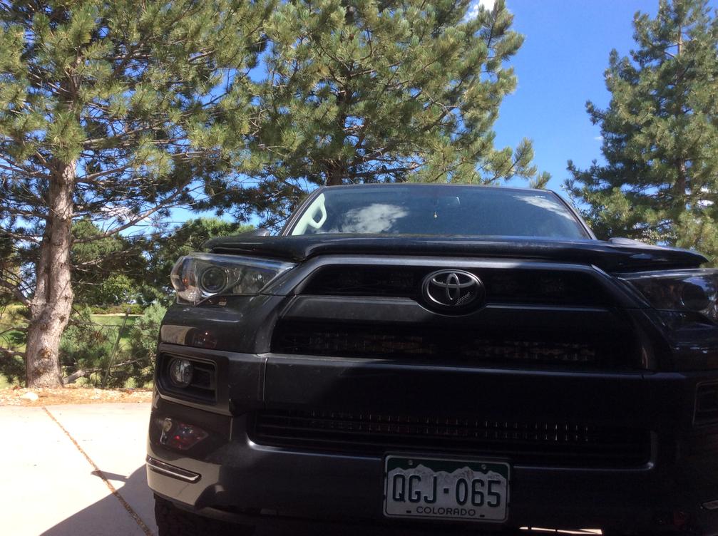

This was how I mounted my 32" light bar on 2016 Limited
I just used some L concrete bracket from lowe's.
The item is 17958 usp 2-in x 5-3/16-in cncr $3.15 x2 that's what's on the receipt.
I just drilled into the aluminum bumper near a existing hole an used a nut and washer to secure it.
If I wanted to add another light bar to the middle grill area, I would add extension to the bracket and secure it.
What size drill bit did you use for the bumper tap, and what size did you use for the new hole for the light mount. I noticed you didn't use the existing holes on the mount. I just purchased the exact same brackets which is why I ask.
Sent from my SM-G930T using Tapatalk
I just used the appropriate for the nuts and bolts That I had. Make sure you don't drill to large of a hole. The bumper is aluminium so very easy to drill. Use washers and preferably locking washer ( I think that's what they're called)
I didn't use the existing hole on the bracket because title was too big. Plus it wasn't in the correct position. Brackets are easy to drill also.. just measure the distance and angle to make sure everything is straight. I used the supplied mount for the light bar and attached it to the brackets. This will help it from moving or tilting.
I drilled 2 holed to mount the bracket to the bumper. Use the existing hole on the front of the bumper to help with the install the nuts and bolts . Check the height of the light to make sure it is centered in the lower grill..
Sorry for any grammatical errors. Writing has never been my strong point

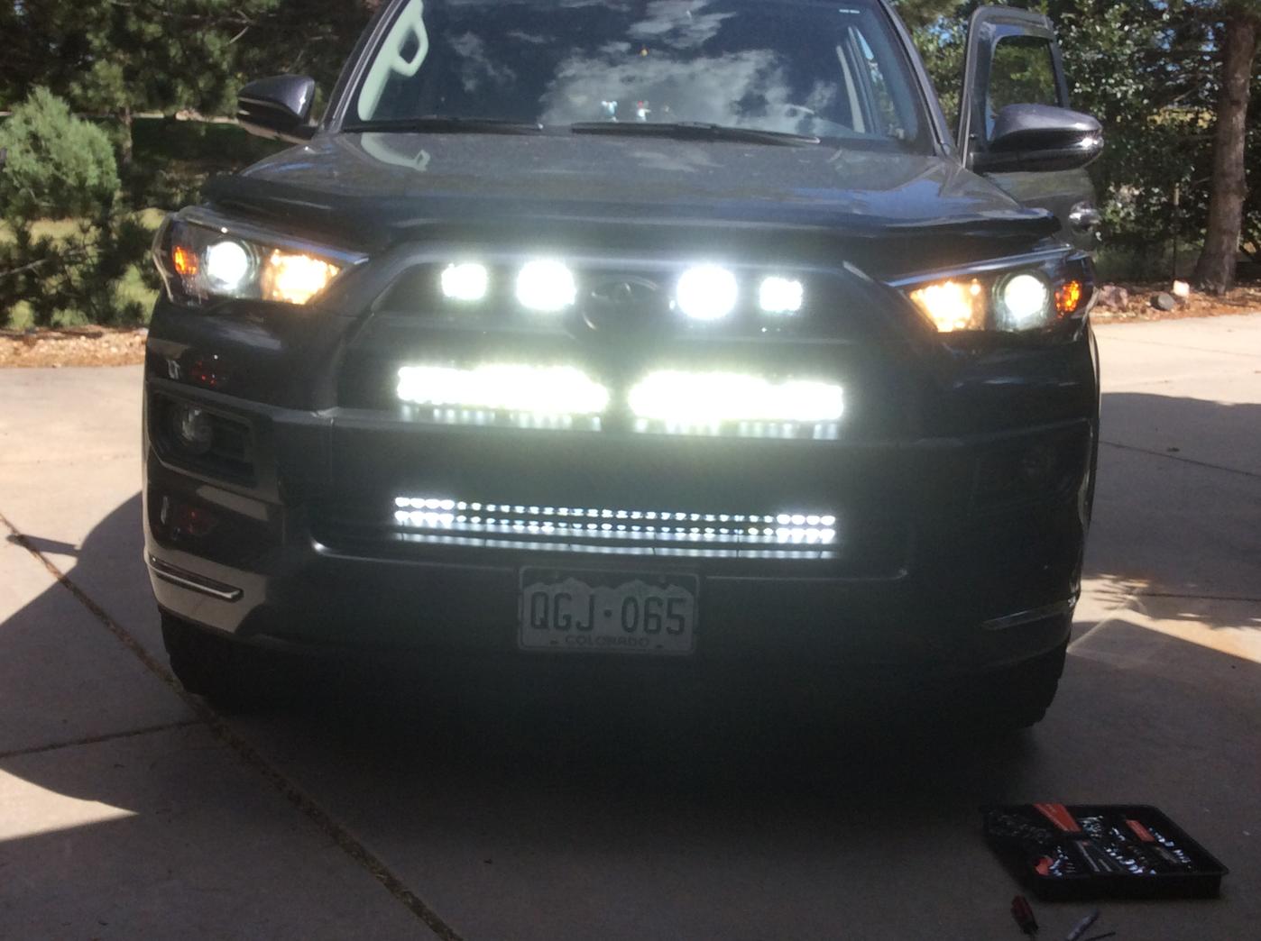

Finally got everything I need for the install of LED light bar and 4 spot lights that go on the top part of the grill. Install will be happening this weekend, stand by for pics and step by step info.

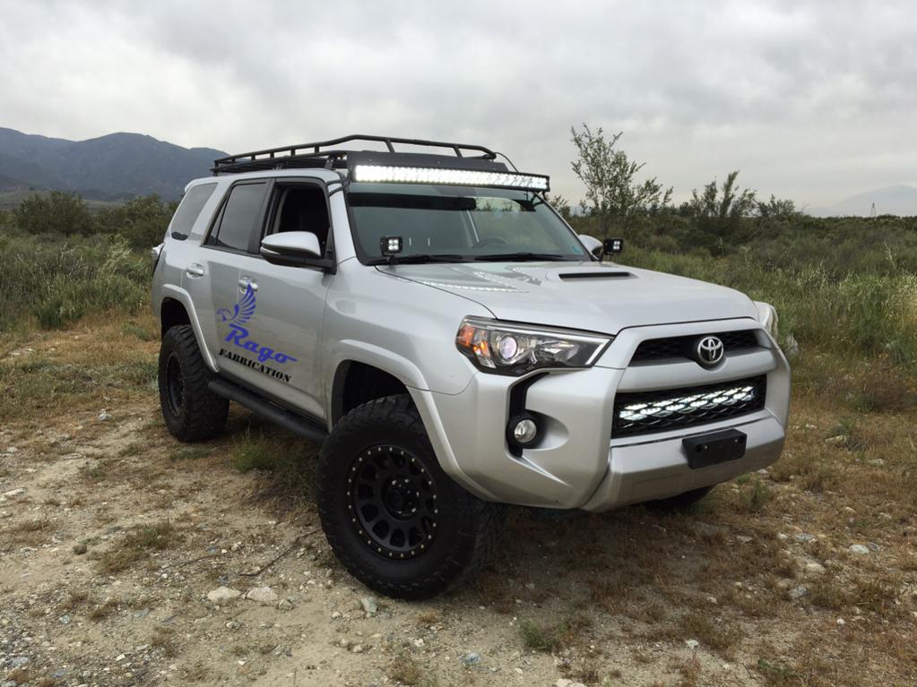

Here is a pic of one of our customer's 4Runners. It is not a limited....but it still looks great.
He has a 50" radius bar with our brackets, our ditch light brackets with pods, and a 30" straight bar with our hidden bumper brackets.
The customer bought the Rough Country bar and they are pretty kick ass. The way it is designed helps eliminate a ton of the wind noise.

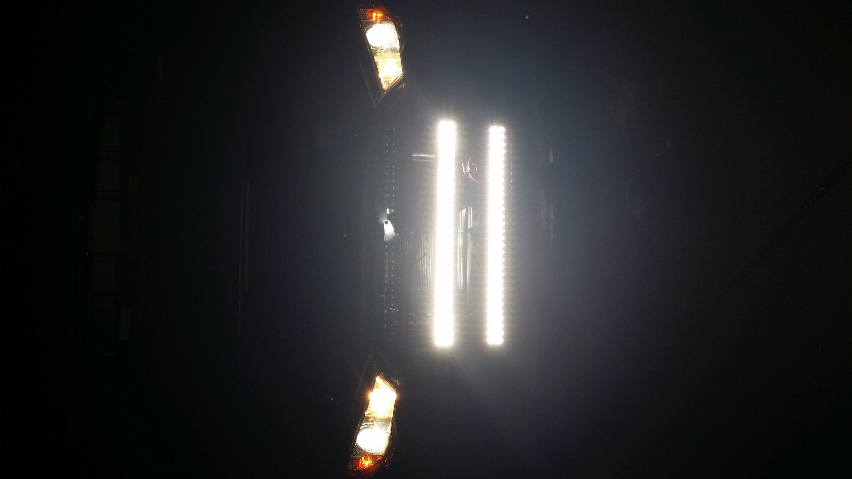

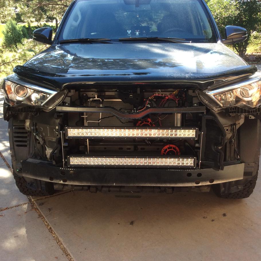

I bought couple of opt7 32" led light bars and decided to install another one on the LE.
Here is a picture of the somewhat complete setup.
