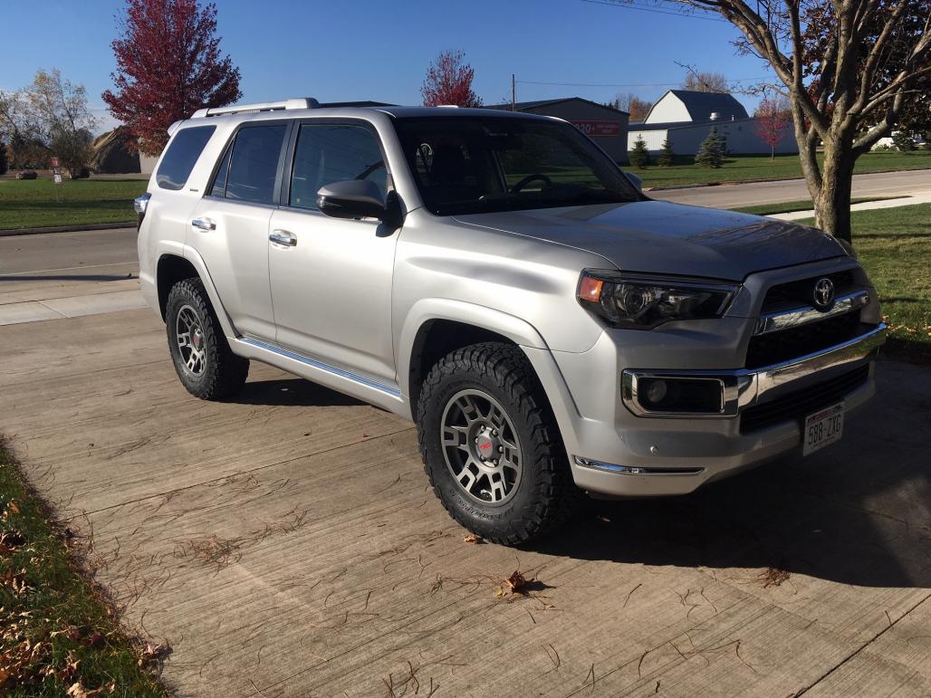

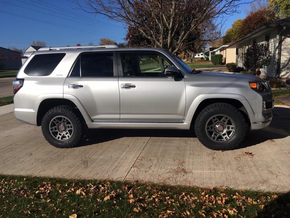

Pros = more tire sizes. The TRD OffRoad wheel is an excellent choice. Ride is still firm in the corners. No change in MPG for me. 17.4mpg all winter.

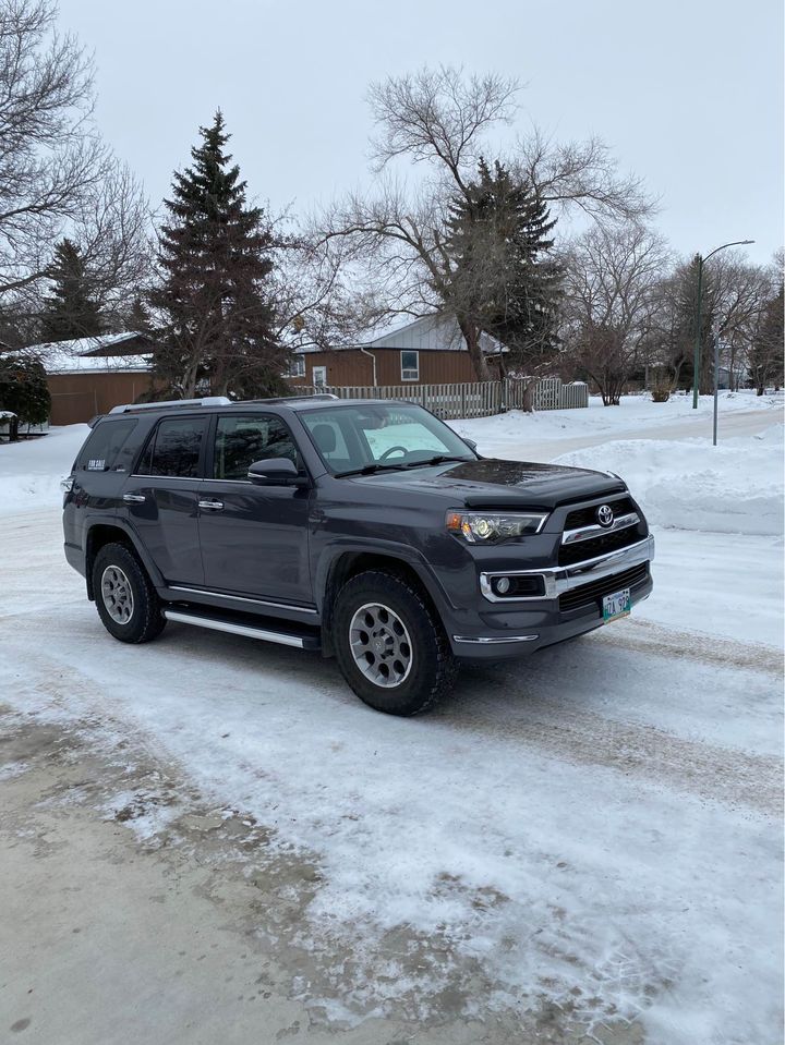

I ditched the 20's years ago, the 17's definitely ride nicer on the garbage roads around here, potholes, etc. I went with 255/75/17 Duratracs, the ride is improved, and winter traction is excellent. I also feel it looks a lot nicer on 17's with some sidewall.

Where did you get the rims?

Hello, I was wondering where you might have gotten those rims? They look like the ones that came on my 2013 FJ and I love the look. Also, did you have to modify the inner fender well? I just picked up a 2022 LTD and really don't like the ride on the 20s. Did going to 17s vastly improve the ride on your rig? Any input would be great before I pull the trigger on a mod like this.

The FJ OEM 8-hole rims (grayish color) are the same as the ones that came with the early 2010-2013 4Runner Trail edition, just a slightly different (silver) color. They both should fit any 5th gen just fine with no mods, assuming a stock tire size.
They are FJ Cruiser wheels, I can't remember the year/trim though. There are very similar 4Runner wheels but they are silver instead of gunmetal.
No fender trimming to make them fit, but depends on how big you go for tires I guess.
Ride quality was greatly improved over the 20's.
Seems like wheel offset from 17" and 20" is not an issue. Appears it is bolt on and go-nice.
